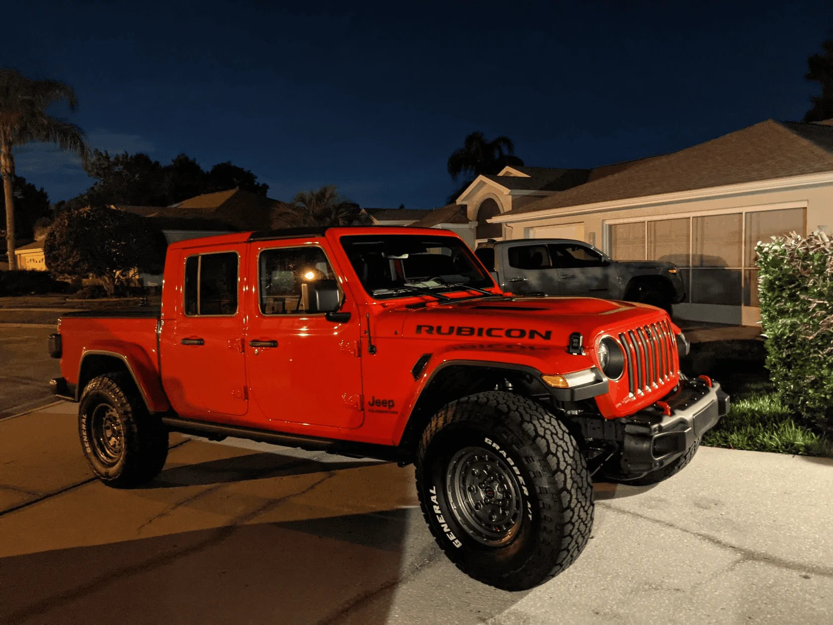

Rubicon with 37's no lift on 0 offset Warn Epic Jackhammer wheels. I wouldnt run this off anything extreme, but around town and such no rub at all and plenty of space.
Jeep Gladiator 37s no lift 1623700761031

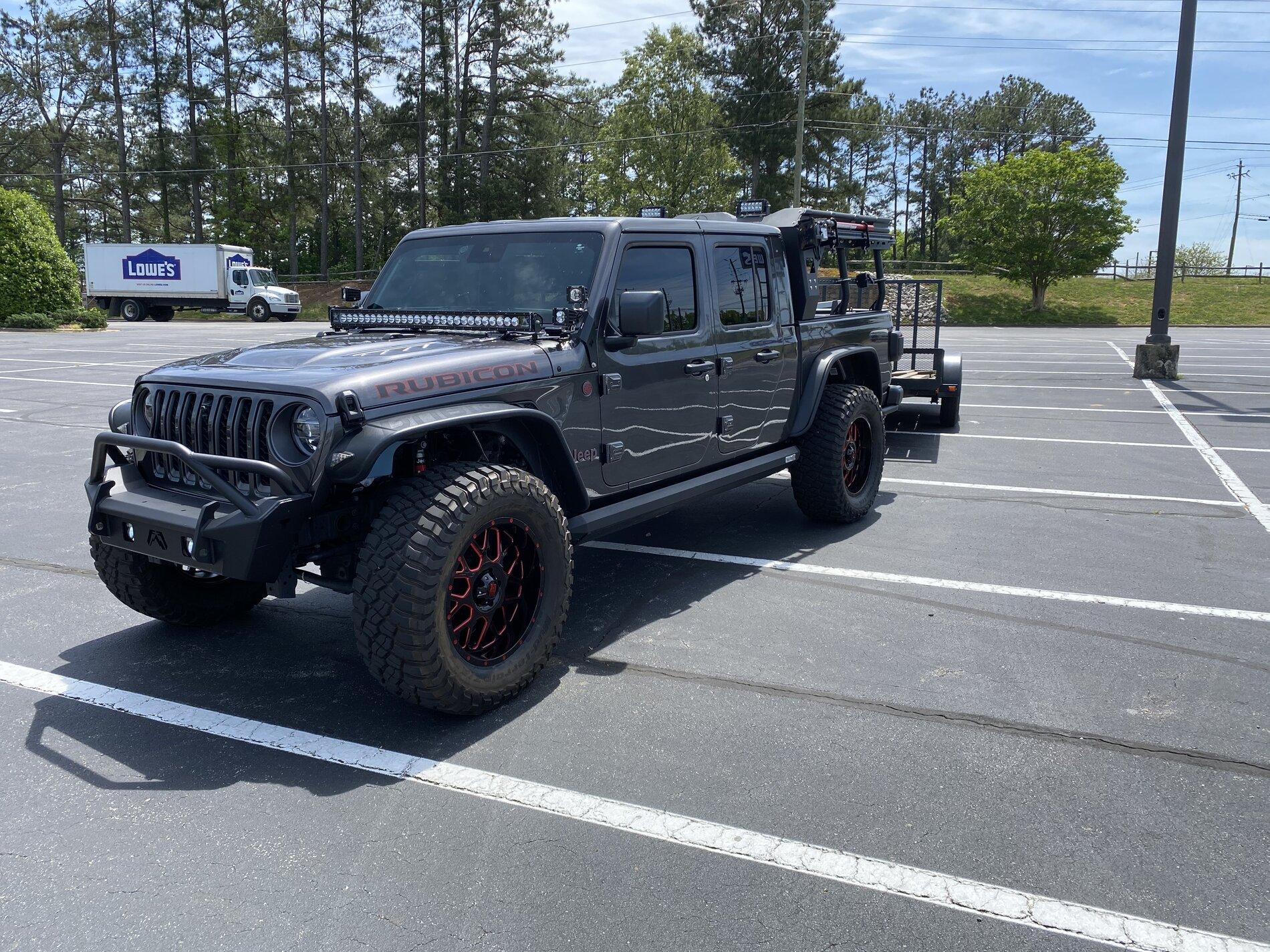

Around town you should be fine. I had 37s for a month waiting on my lift parts.
As for off road… if you disconnect your sway bars… look for major rubbing. I wouldn’t do too much off roading that requires articulation. That will be a challenge.

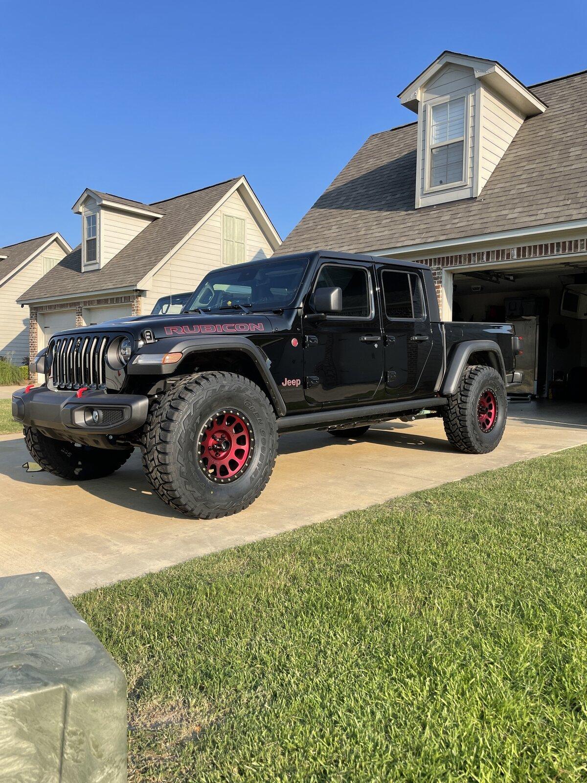

After my lift went on backorder… and I had already bought tires… I found this thread to see if they would fit. They definitely will, and most definitely would not be going off road on them. Toyo 37x12.50r17 on Method 17x8.5” wheels with no offset, 4.75” backspacing.
Jeep Gladiator 37s no lift A7454571-1797-4BEB-BB0A-1CBA5642602B
