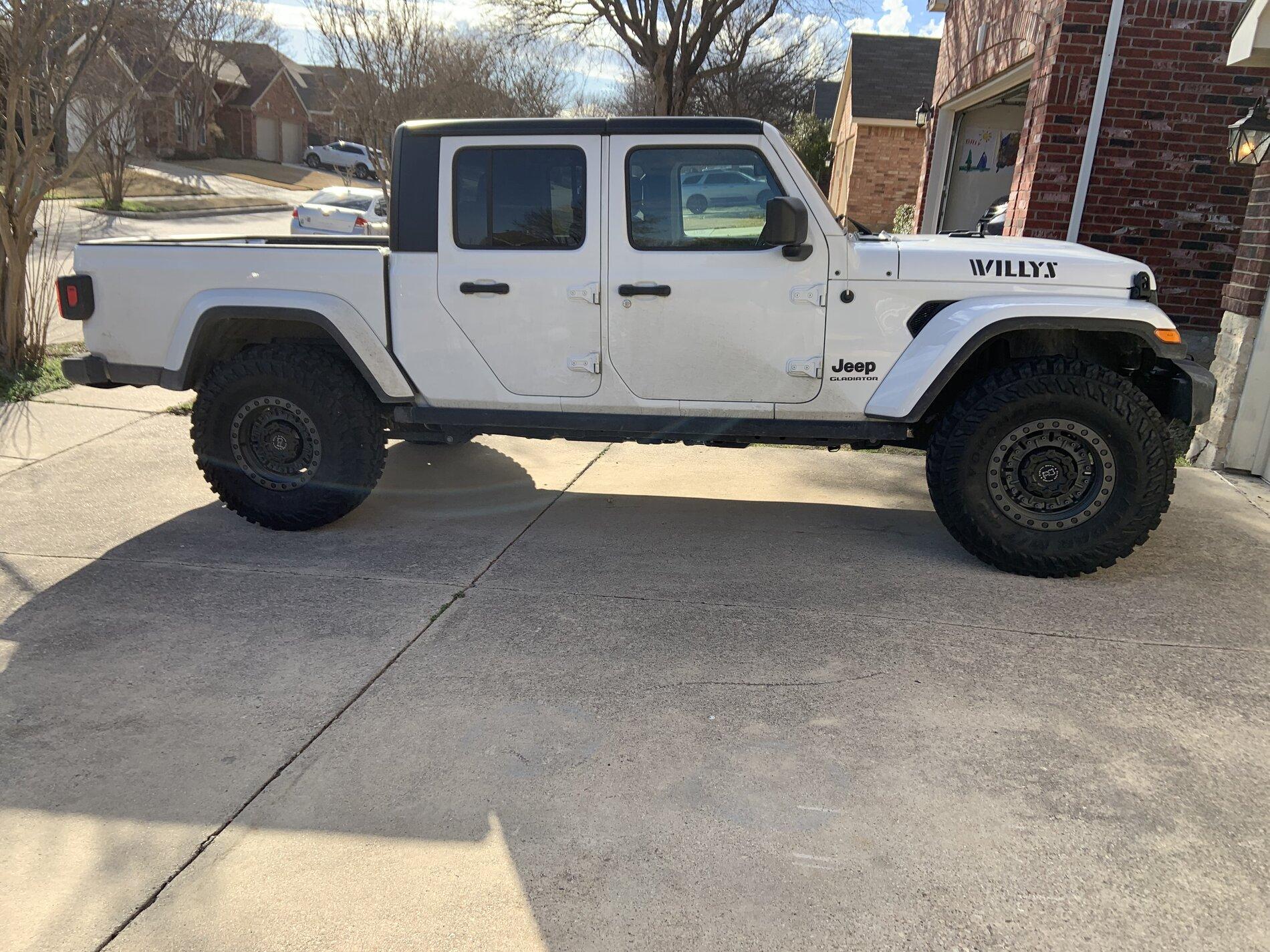

I'm getting some Black Rhino Abrams wheels and 37x12.50x17 Yokohoma Geolander MT's later this week. Can I get away with running these on my Sport S Willys with just a 1.5" leveling kit for a couple of weeks until my Clayton 2.5" lift gets delivered? I wouldn't be taking the truck off the pavement until I install the lift kit.

And here it is. No rubbing at all. Of course I won't be doing any wheeling until the real lift goes on.

I think the Geolanders handle great, and they're relatively quiet for a big M/T tire. I run them at about 32 psi.
It did ok with stock gears, but I wouldn't keep it that way. It never saw 7th or 8th on the highway. I ended up going with 4.88's.
