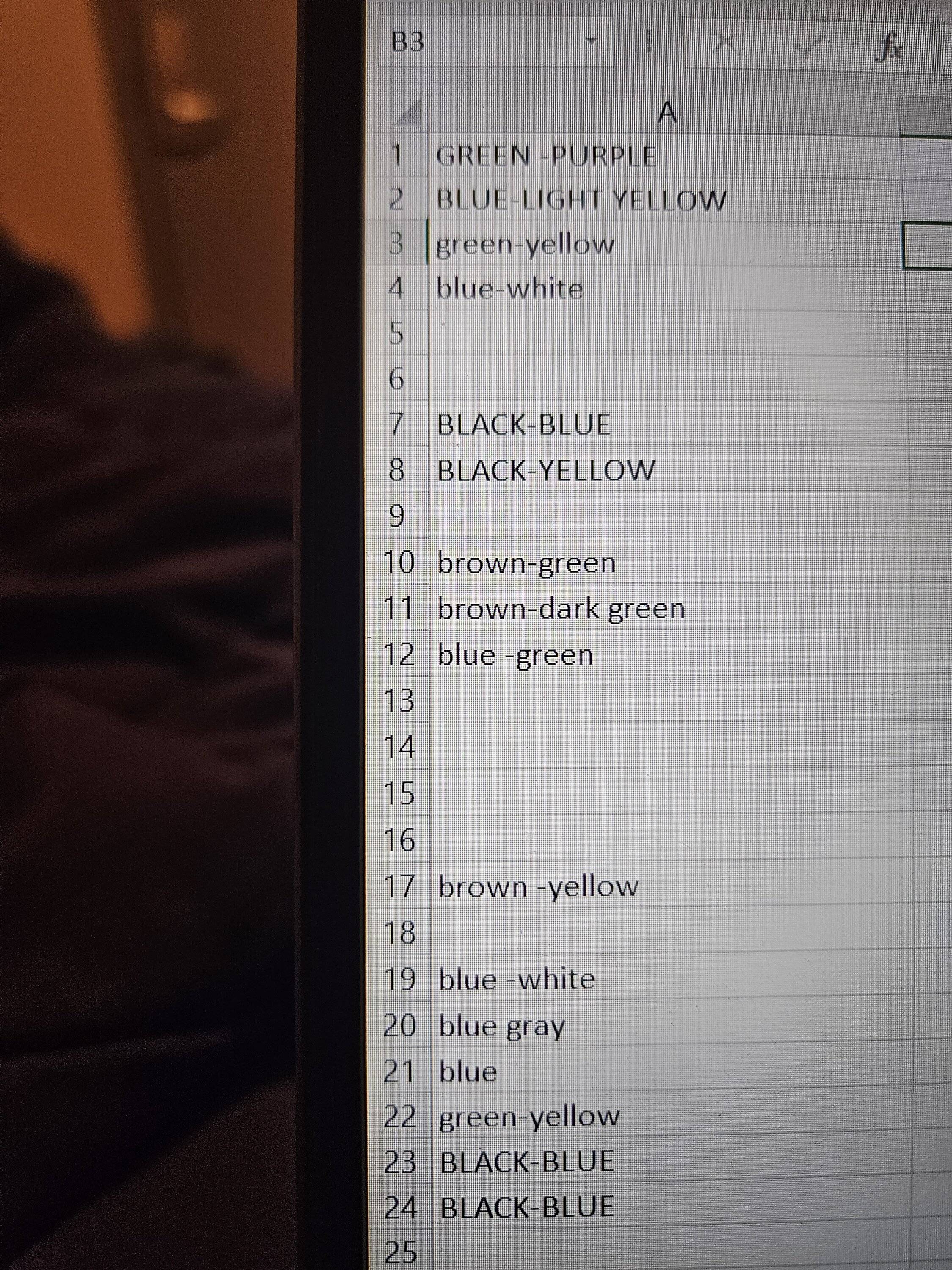

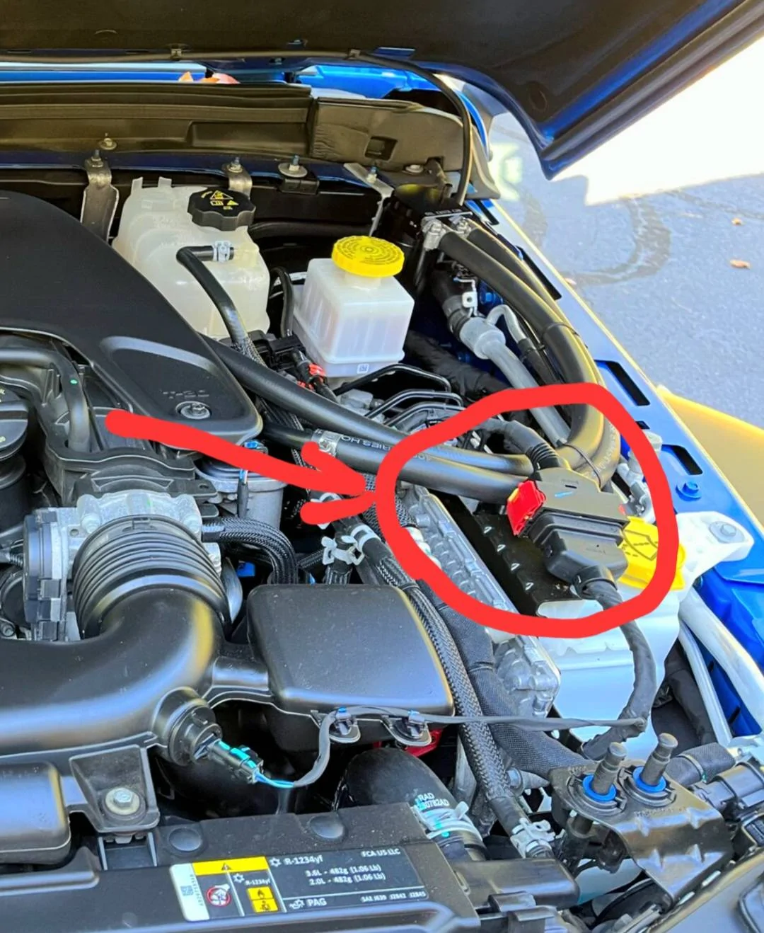

Hello guy i wonder if someone have acess to technical data or wiring diagram and can sort out what is the name of this connector (engine to body)and have the function according to wire color and location my jeep its a 21 and have 3.6 gas and auto trans in it . Its a 24 pin connector from
Te (tyco electronic) i know that like starter activation should be one of them but i plan to do my own wiring to make 6.4 work so this is a piece of puzzle i missing right now that could help thanks you very much !

I have found this link to be a great resource for identifying connectors and pin-outs if you don't have the FSM. I would recommend if you're doing something this advanced you invest in a subscription to Tech Authority, though.
http://connectors.dcctools.com/home.htm

Sent a PM
I also found on mopar site every connector break down from rear to front bumper as per any chrysler ,dodge ,jeep , pinout and part number wanted to share with you guys could be a handy link for any electric,diagnostic repair or mod searched this for months here it is , https://connectorrepairkit.mopar.com/
Looks like the link I posted is now this one! Apologies, the link I posted doesn't seem to work any more and your link seems to be the new one. Thanks!
Also, check out this thread:
https://www.jeepgladiatorforum.com/forum/threads/gladiator-wiring-diagrams-shared-with-jl.34896/
I have found not all of the connectors/locations/colors are the same, so don't trust this 100%, but it's a good starting point. I think most if not all of the engine bay locations are the same.
