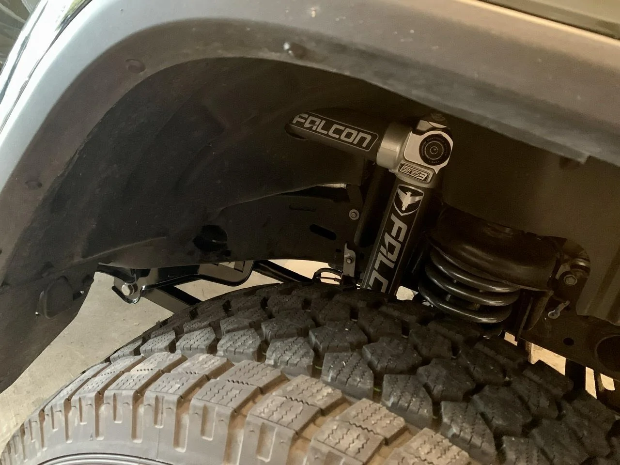

AEV has dedicated 2.5” springs for the diesel, I just added the rears today (fronts yesterday).
Jeep Gladiator 392 springs and shocks 8B8CAC9A-E32D-4EA5-B7F2-91FDAEB56095
Sport S Ecodiesel or Rubicon?
Edit.... nevermind saw that.
Got any full pics?

Not yet, just completed today. The net result is 1" rake with a bumper & winch up front and rack & RTT in the rear. It did give a full 2.5" even with the extra weight. I had the AEV 2" spacer kit before but lost quite a bit up front on the stock springs post bumper & winch install. The springs are available for purchase separately, $549 shipped from Northridge.
Running 392 JL gear seems like an unreasonable stretch given there are so many options available for the diesel now. It sounds like your shop has a set of take-off 392 parts laying around that they want to move. Heck, they even have a used part category on their website which is a wee abnormal for a standard shop.
