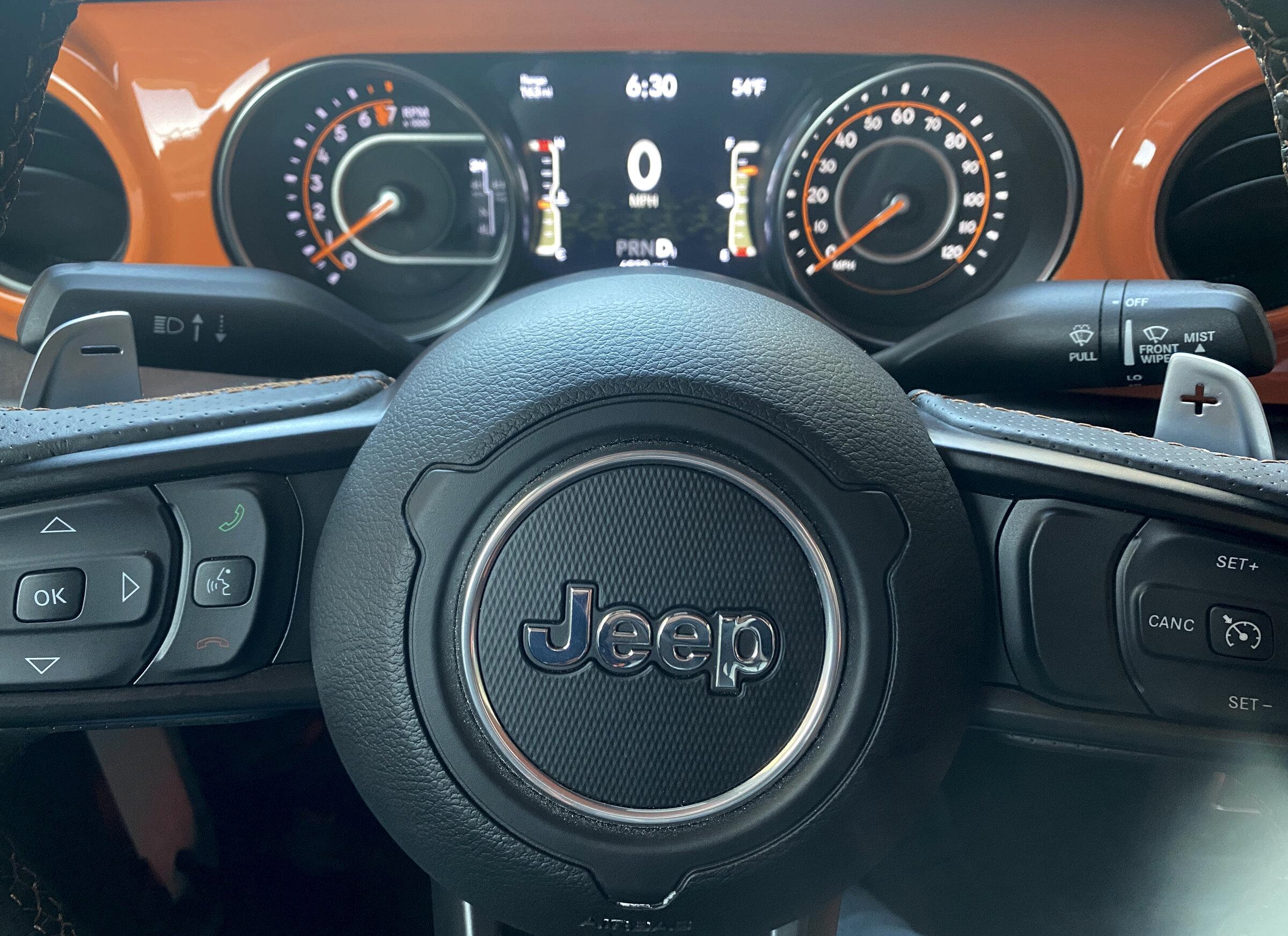

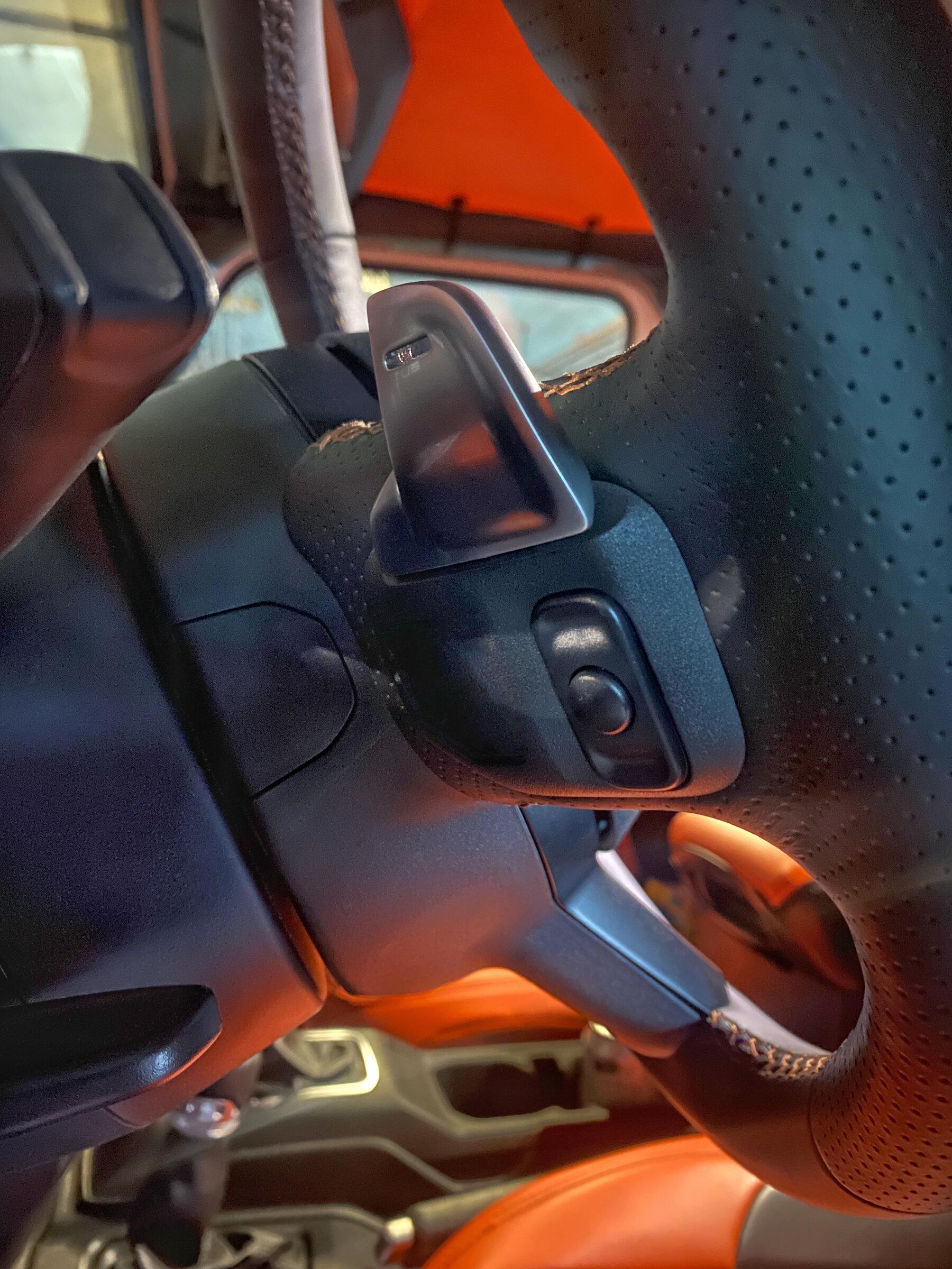

Any ideas folks?
The shifters work except for this little glitch.
Also, I don’t have the “UpShift” indicator in the cluster.

Any ideas folks?
Don’t enable the paddle shifter CSM. It doesn’t function on our Jeeps and isn’t necessary. None of the MOPAR vehicles that currently come with paddle shifters have that enabled.
You won’t get an upshift indicator. The Jeep will shift on its own at redline if you haven’t shifted yet.
