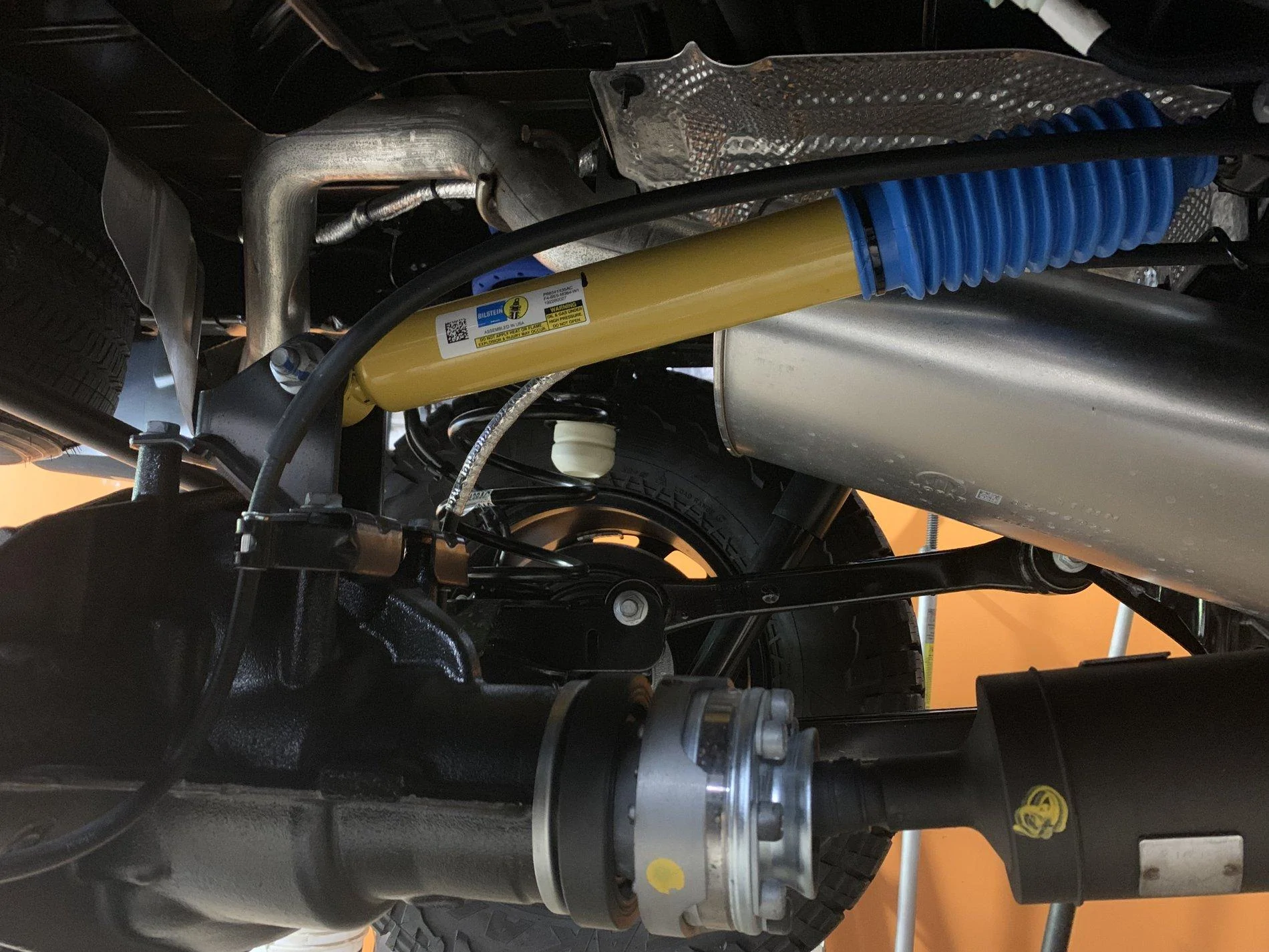

Anybody got a picture of this?

Damn, that's an actual shock. And an expensive Bilstein at that. That's a better shock than the four they use at the corners. Lol. That came from the factory?? Interesting.. I wonder if the "transmission clunk" that we've seen discussed in multiple threads could be cured with that?

As a datapoint, my Sport S with 6 speed does have the same shock

When wiring up my Euro spec rear foglights yesterday, I saw that I have this Bilstein shock above the rear differential. I also have the 6-speed manual. Had to search it out, only because I hadn't seen it on any YouTube video. Guess it's a manual thing only.

It is just on the manuals. From what I've read, FCA added it to the trucks after switching from leaf to coil springs.
