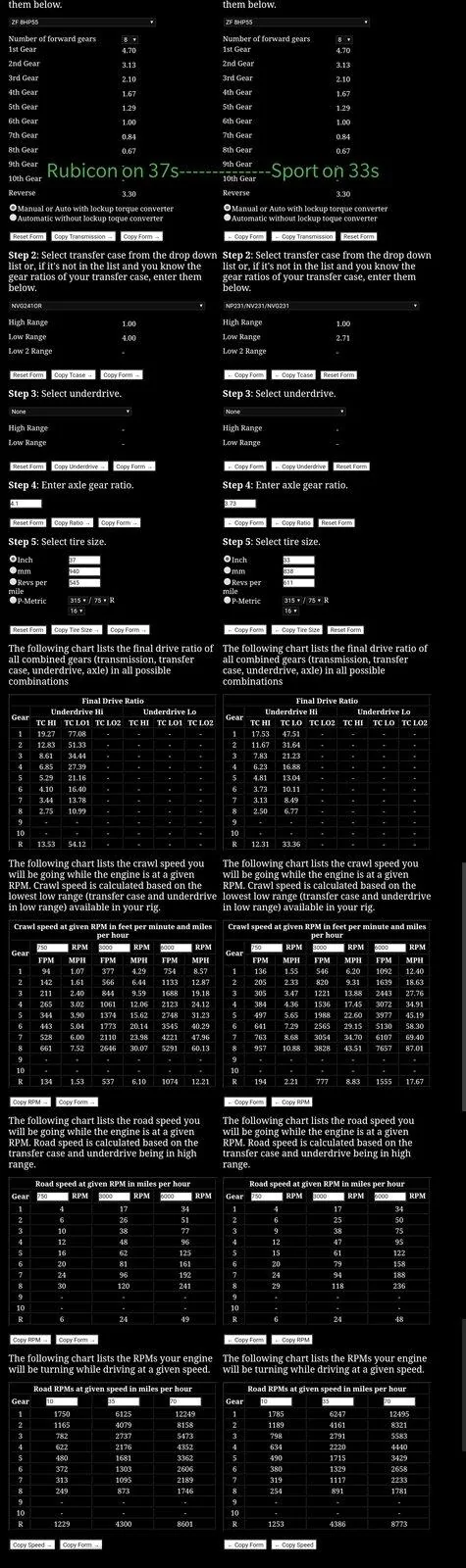

Oscar Indy
Oscar
Aug 21, 2019
32
1,131
1,198
Utah
offmapoverland.com
JTR
