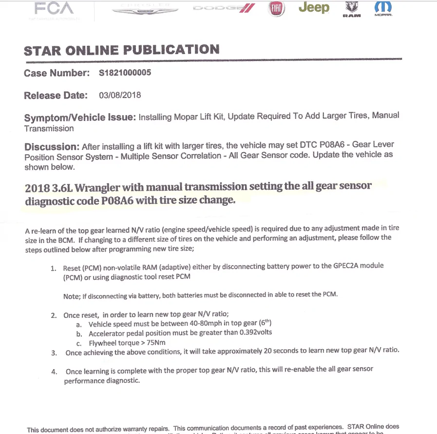

Lastly, my Captain America dash light is coming on and saying the start/stop system needs service, even though i changed the tazer setting to 4.88's when i left the shop. Comes on after each start and get to about 40 km/h. Will have to dig into this, surely it's a simple fix. I have it disabled in the tazer settings so unsure whats up.
