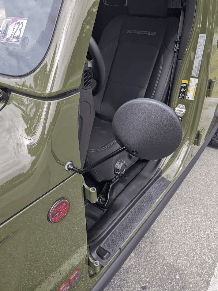

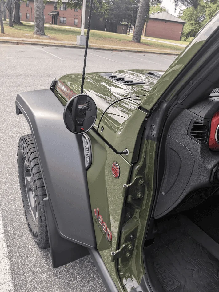

I ordered these scooter mirrors for $3.99 each (no seriously, the shipping was more than the mirrors). Finally got to try them out last week when I took my doors off for the first time. They are absolutely fantastic, I cannot fathom paying any more. They thread right into the cowl panel holes when you remove one of the bolts. You'll see a white nylon spacer in there, I only put that in to keep from scratching the paint around the recess with my little adjustable. 30 second install. Did a 4+ hour trip at 70+ on the highway and they are nice and stable.
The one on the passenger side is a little obstructed by the dash but still usable. But even if you're not worried about using it, it keeps you legal for your municipality. The driver's side one functions perfectly.
If you have the means, I highly recommend picking one (or two) up.
- paraphrased from Ferris Bueller
The same mirrors are available anywhere but I can't see paying a stratospheric $7.99 when Autozone has them for $3.99:
https://www.autozone.com/miscellane...EVAsyekSDIhc4agjRDhoCB84QAvD_BwE&gclsrc=aw.ds

Very nice, are they the same thread pitch as the cowl fasteners?

Yup, threads right in and the nut tightens down to hold them in place.

Couldn’t you tilt some of that bend back over on the passenger side to obtain a little better visibility? Not sure how much pivot you have with the ball on the back of these.

Yeah you sure could. I just didn't feel like getting in and out of the truck 10 times to adjust it. I set them even and was fine with it where it was.
