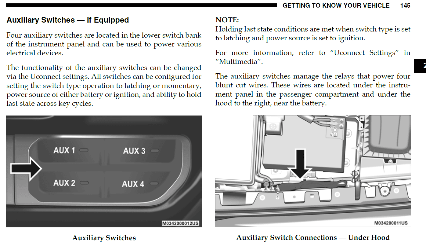

If I recall correctly two of the switches are always hot and two are hot with ignition.

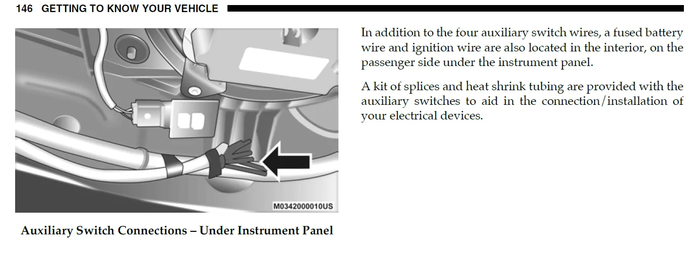

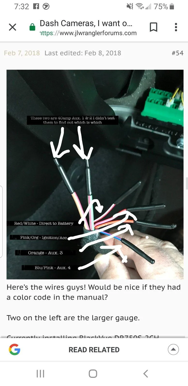

Concerning the 4 Aux Switch Power, you stated "I found that the wiring is already inside the cabin where you can connect whatever your powering". Could you let me know where this was found on your gladiator and what it looked like?

the owners manual shows the locations, the lugs are under the hood but the relay wiring harness is in place from power to switches to relay to consumer.

On the Uconnect screen you configure each aux switch. One of the choices is to have it always powered or only when ignition is on.

here is the key
