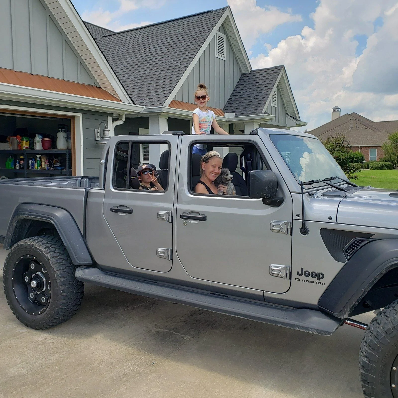

Let me begin with I do not rock crawl. I live in SE Texas, use it as a daily driver and spend most of recreational time at work... I do however enjoy the occasional trip down a pipeline and cruising Crystal Beach. I am currently running 37x13.50r22 RBP Repulsor's and am thinking about going up to a 40" tire once these are done or maybe a little earlier. My Gladiator is a Sport S w/ Max Tow pkg. I believe I'll have enough room with the Skyjacker 3.5" lift to do this without any trouble. I already plan on chopping the fenders with the AAL chop kit. I'll also likely need to install a stubby front bumper. I've seen a couple of people running 40"+ on the Skyjacker 4.5" lift but haven't seen or heard of anyone doing it with the 3.5". Is there anything I'm missing that I'll need to do this? Anyone else doing it?

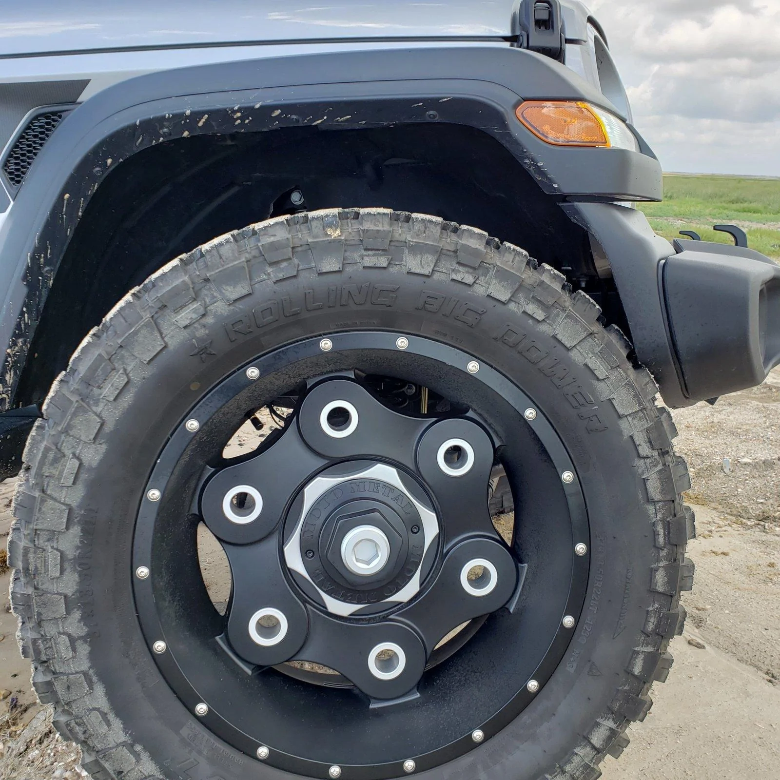

Those are some cool wheels. What are they?

Normally not my thing...but there is something I really dig about them. Thanks for the info.

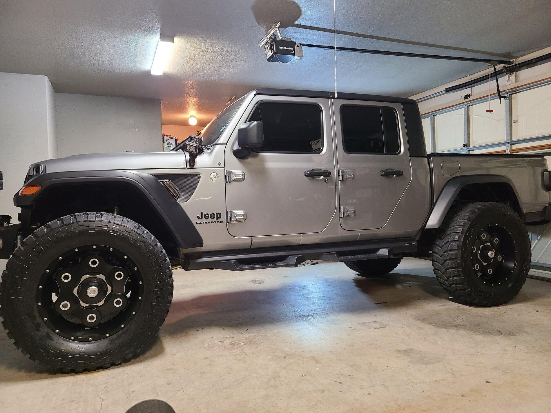

Looks great. Was there any trimming needed?
I chopped the rear fenders but I'm not 100% sure I needed to. There is about 5-6" of room all the way around the tire now, it probably would've been around 3-4" before I chopped it.

Did you re-gear prior to this? Or still running the 4.10's. I can't imagine you more than 8 mpg if you didn't...
Still 4.10's. Regear is definitely on deck. I've made a few quick trips and the wind is howling here but I've dropped from ~15 to ~14. I'll have a better idea after a little bit of driving...I'm sure it will continue to drop. It is very noticeable vs the 37's
