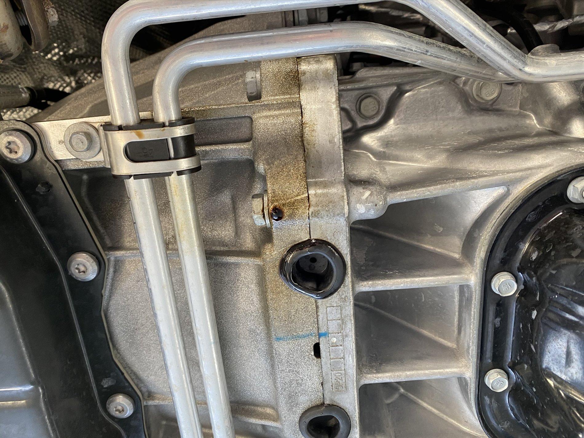

Just noticed 1 small spot of oil on the garage floor a few days ago and it has continued to multiply. Looks to be leaking between the engine and tranny. Hope it’s not the rear main seal. Guess I will schedule an appointment tomorrow.

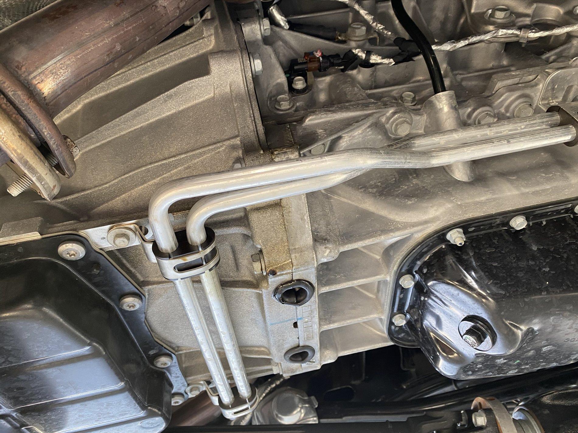

90% of the time oil from the back of the engine when the source is difficult to find, is a leaky valve cover. The good news is that it is the easiest of fixes. Good luck!

There is NO oil anywhere but the picture where the bell housing and engine meet. It’s crazy it leaks for me but not the shop. Glad it’s under warranty. Thanks for the reply

Remember, the oil viscosity is 0w-40 and these engines run clean. It is always much easier to see where it collects vs. where it runs. In fact, it will be almost impossible to see with the naked eye. I know the dealer is looking at it, but if you get it back again unfixed. Take a blue shop paper towel and dab the back of the valve cover at the head holding it in place for a second or two and then inspect the towel. One dab, one inspection, working your way from the back of the VC down to where you know the leak is. It will be hard to get your hand in there, but give it your best shot. Any wet spot will be absorbed by the towel. Report back.

Not sure how they couldn’t find the leak but I now think it’s the oil pan gasket. You can see where it’s around the pan gasket really good from the passenger side with the dye and a black light. I have it scheduled at a different dealership next week. The first dealer not being able to find the leak was frustrating but when I picked it up and they left it with little to no gas after putting 109 miles on it that was the last straw. I’m sure someone will think I’m being petty but I paid a lot of money for this truck and expect more out of a repair shop. I will update the thread when I know for sure where the leak was coming from. I have a video with the black light but cannot upload a video to this website for some reason.
