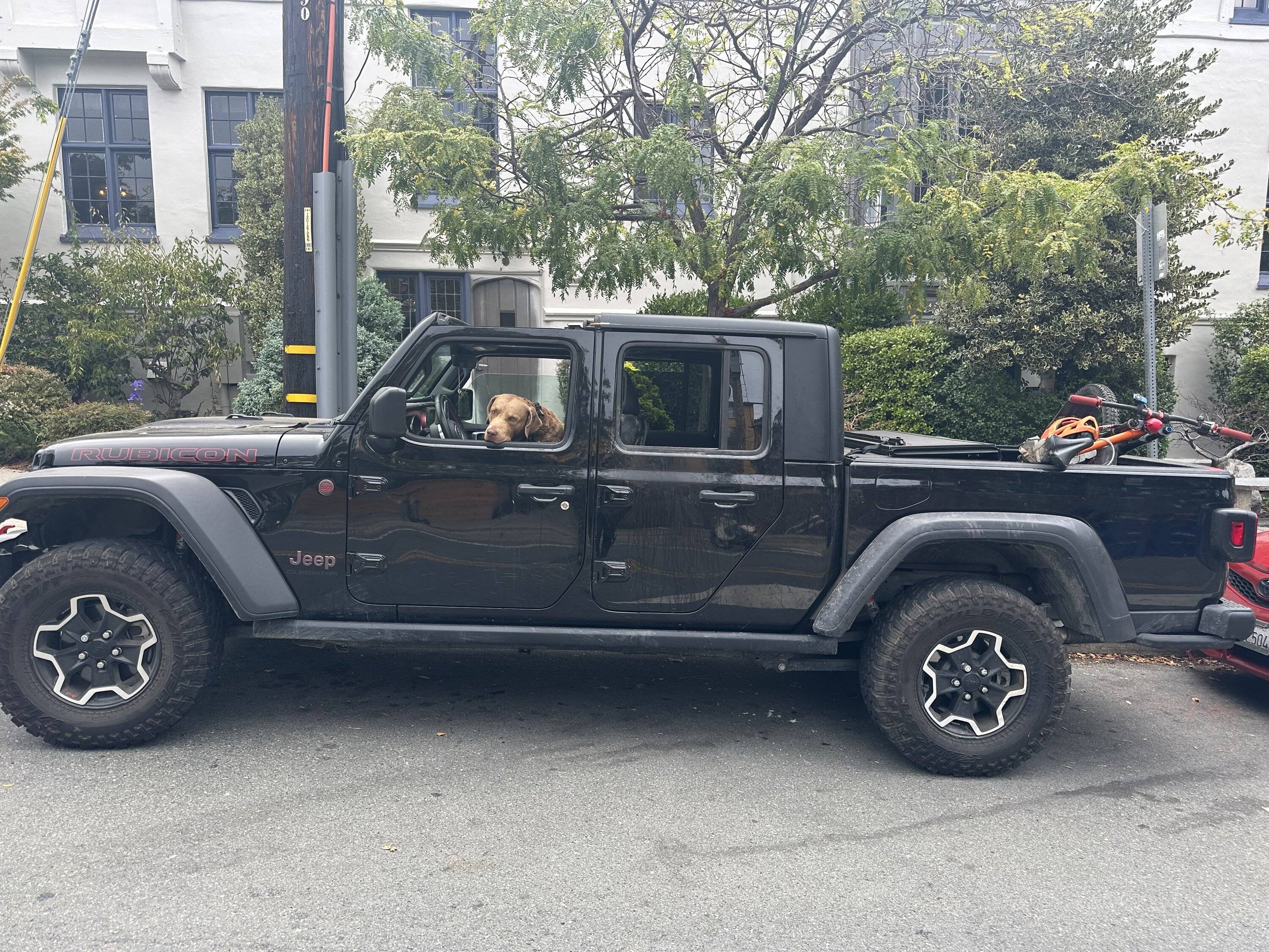

Would a 426 Hemi engine swap, AMW 606 engine and transmission basic package circa net $36K, be reliable and durable, for a 2022 JTR?
I like my new Gladiator Rubicon, but I miss the useful power of my old truck I had traded in for.
I’d prefer a 426 now and then later may add a super charger.
Jeep Gladiator 426 Hemi swap on existing drive train IMG_2684
