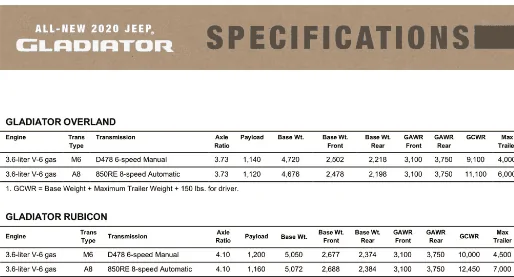

Just saw that the Rubicon is only rated for 4500lb trailer towing, and only 1200 payload with the 6 speed manual.
Guess it's a good thing I'm holding out for the diesel.
Both 4500 towing and 1200 payload are likely to be fine for me, but why limit myself?

How about the fact its even less on the manual trans sport. Im still going for a manual but it is disappointing that the manual takes such a big hit.

So you should compare apple to apples though, the Pentastar with auto is 7000lbs on the Rubicon. If you're waiting for the diesel then you're getting an automatic there as well... it will probably? be right around the 7000 lbs again, probably less. They've stated that cooling is an issue in the Diesel with towing. Also, the diesel will weigh more which brings down all capacity numbers accordingly.
Edit: It sounds like the Diesel will be about 500 lbs less in towing capacity, so the JT Rubicon Gladiator w/ Auto & Diesel will have a towing capacity of ~6,500 lbs.

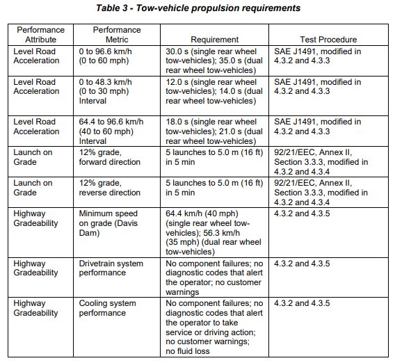

The more I think about it, the more I'm inclined to agree. Typically, it's the automatics that suffer from heat and not the manuals. It's gotta be the clutch.
Interestingly, however, the Tacoma tow rating doesn't change with the 6MT option. A Ram 2500, on the other hand, loses about 1000 lbs towing capacity by choosing the 6MT.
Assuming that it's the hill starts that murder the clutch, it's interesting to look at the gearing numbers for the JT, the much-better-for-towing Ram 2500, and the somehow-equal-to-an-automatic Tacoma. The JT Rubi apparently gets a 5.13 first gear and a 4.10 diff for a total reduction of 21.03, whereas the Ram 2500 has a 5.94 first and 3.42 rear for a similar 20.31 reduction (but the massive low-RPM torque of the Cummins would certainly reduce the need to slip the clutch on hill starts). The Tacoma has a relatively tall 3.98 first and 4.30 rear, totaling a clutch-murdering 17.11.
(Note that all of these numbers disregard the effect of tire diameter on torque transmitted to the ground, but there isn't a great deal of variation in tire size between these vehicles.)
Since the JT and the Taco both follow the SAE J2807 towing standard, it's strange to see that the JT takes such a hit with the 6MT while the Taco remains unchanged, especially with its unfavourable gearing. Perhaps it has a much more durable clutch, or perhaps Toyota's interpretation of J2807 is different somehow.
For reference, here's the J2807 standard's test structure and requirements:
