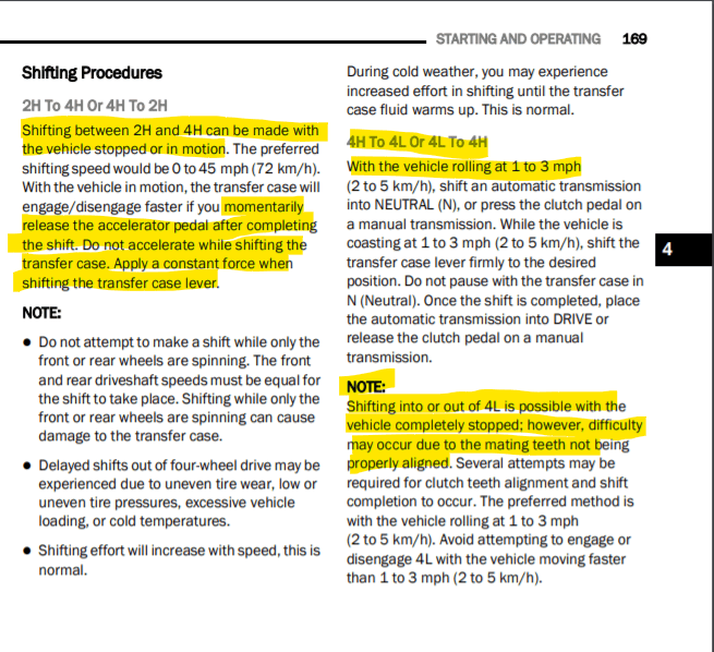

I've been driving an AWD Land Rover 2sp transfer case but permanent AWD with a lockable center differential. The JT system is new for me although i suspect it is pretty typical of 4WD trucks. Anyway I had to read the manual a couple of times. See in particular the section titled shifting procedures. It says you can shift from 2H to 4H while moving, and they recommend shifting from 4H to 4L while moving 1-3mph - the Note below this section explains that you can do this at rest too but the gear teeth may not be perfectly aligned on your first attempt. I suspect that in your OP when you described shifting into 4wd (4H?) but then getting kicked out of 4wd was because your first shift didn't fully mesh the gears in the transfer case. Just a thought.
