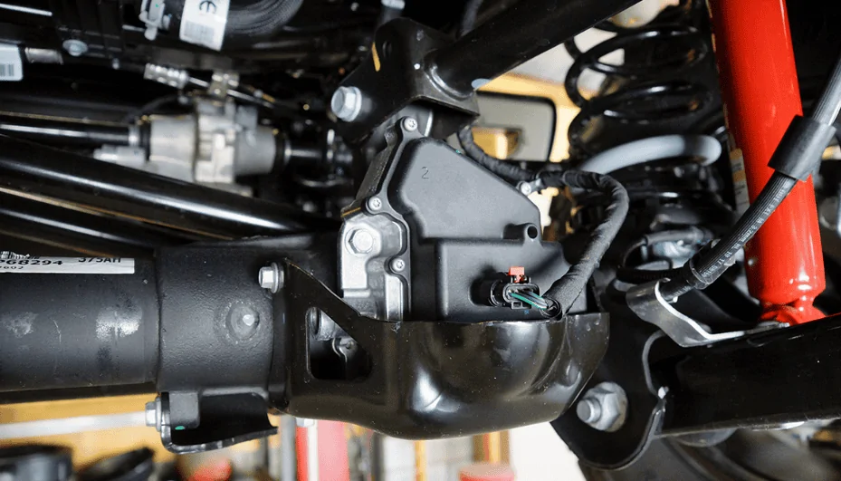

I think because of the FAD the JT/JL are not as easily shifted from 2H to 4H as the JK, because when in 2H the front output of the transfer case is not turning when in the vehicle is in motion as it is with the JK. Defiantly easier to shift from 4H to 2H, I have noticed while moving after you shift from 4H to 2H and quickly shift back to 4H (before the FAD disconnects) that it is a lot smoother shift.
What FAD are we talking about?
Right on the money. 4H to 2H is easy smooth...then shifting quickly back to 4H is much easier.
