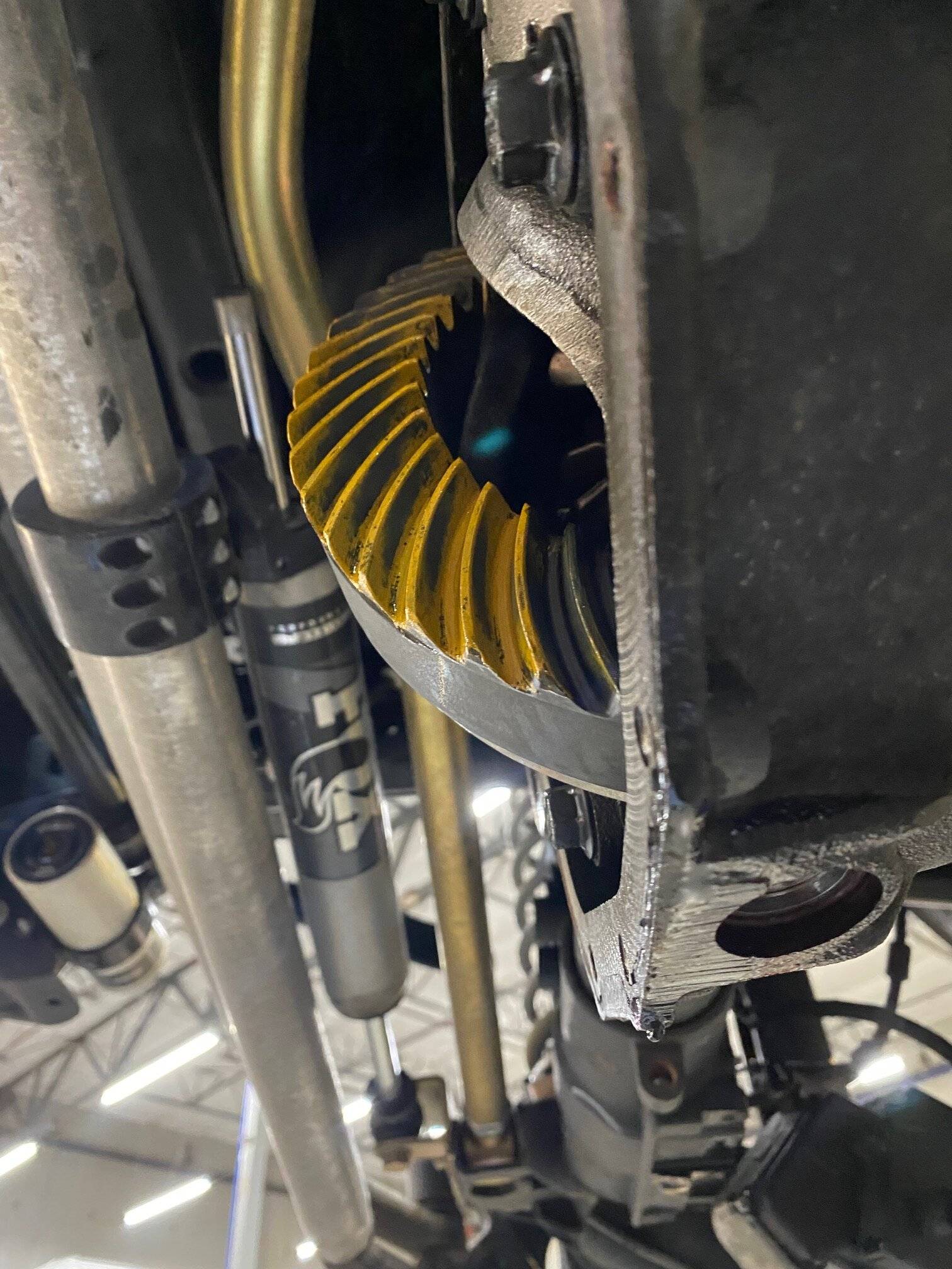

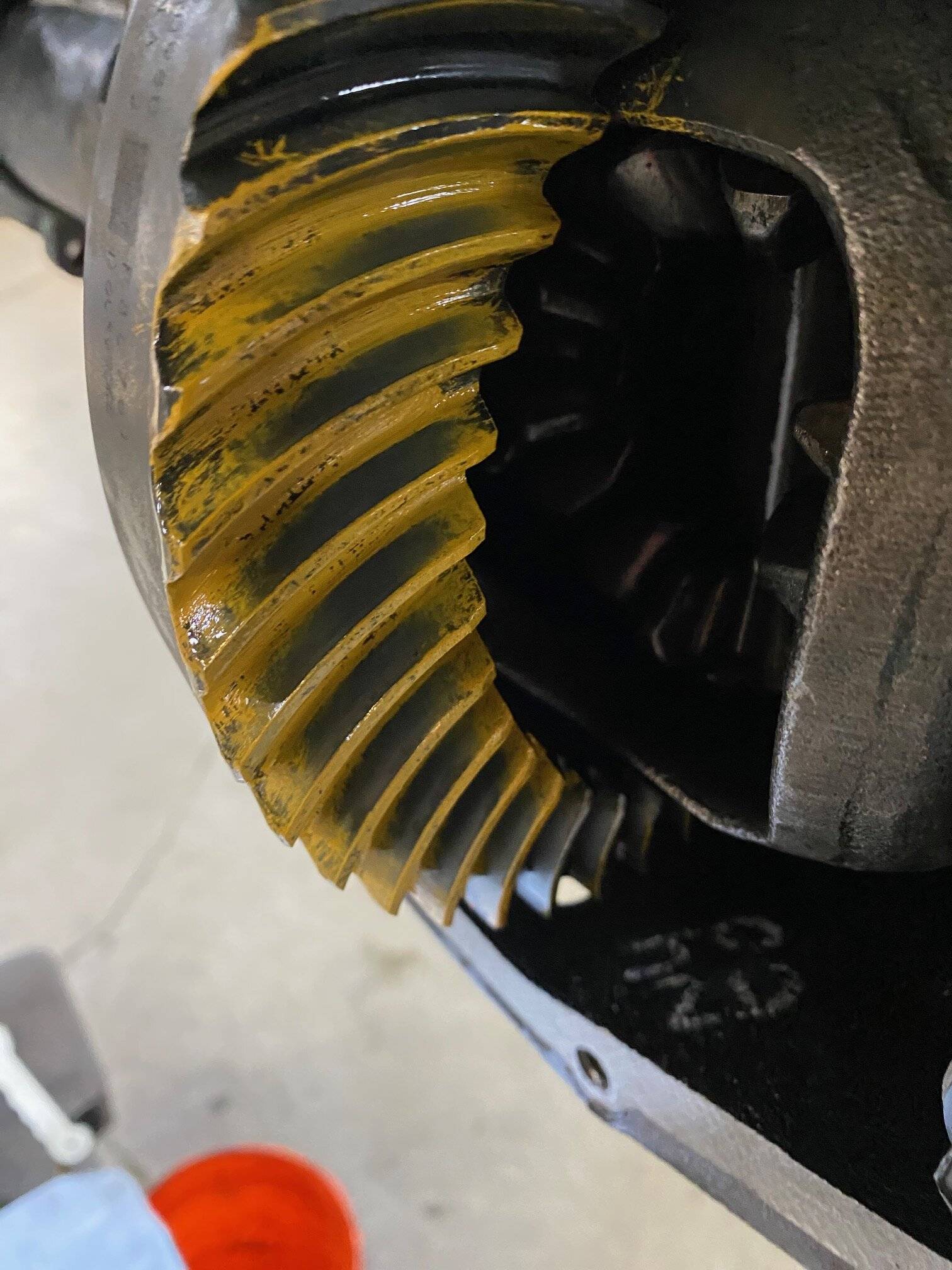

Quick shoutout to the shop too...MULE Expedition Outfitters in Preston did a bang up job. They shared a pic of the gear patterning and it was absolutely perfect with minimal work to set up. Combination of great gear set (Dana Spicer) and installer.
