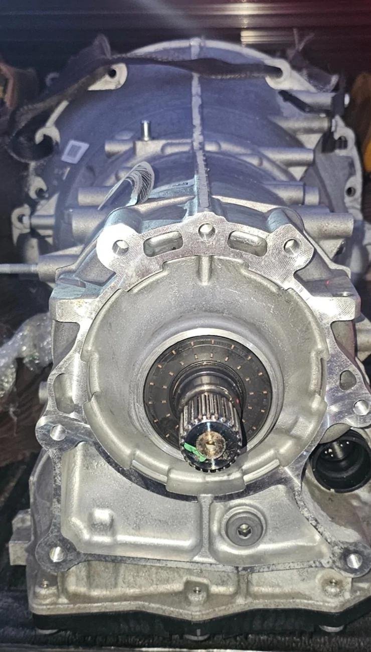

@Red_gladiator just a word of advise, double check the spline count on any transfer case you look at as the 8HP50 has a different spline count on the output. The 392, 4Xe and six speed manual transmission have a 43 spline output while the 8HP50 has IIRC a 23 spline output.
Gregj
Thanks for your advice,
The ZF 8hp75 that come on the RAM 5.7 had 23 spline, as I attempted a pic om my 8hp75 transmission šŸ‘‡šŸ‘‡
Ugh thanks for making my OCD kick in had to count those splines to make sure there was 23 🤦:LOL:
