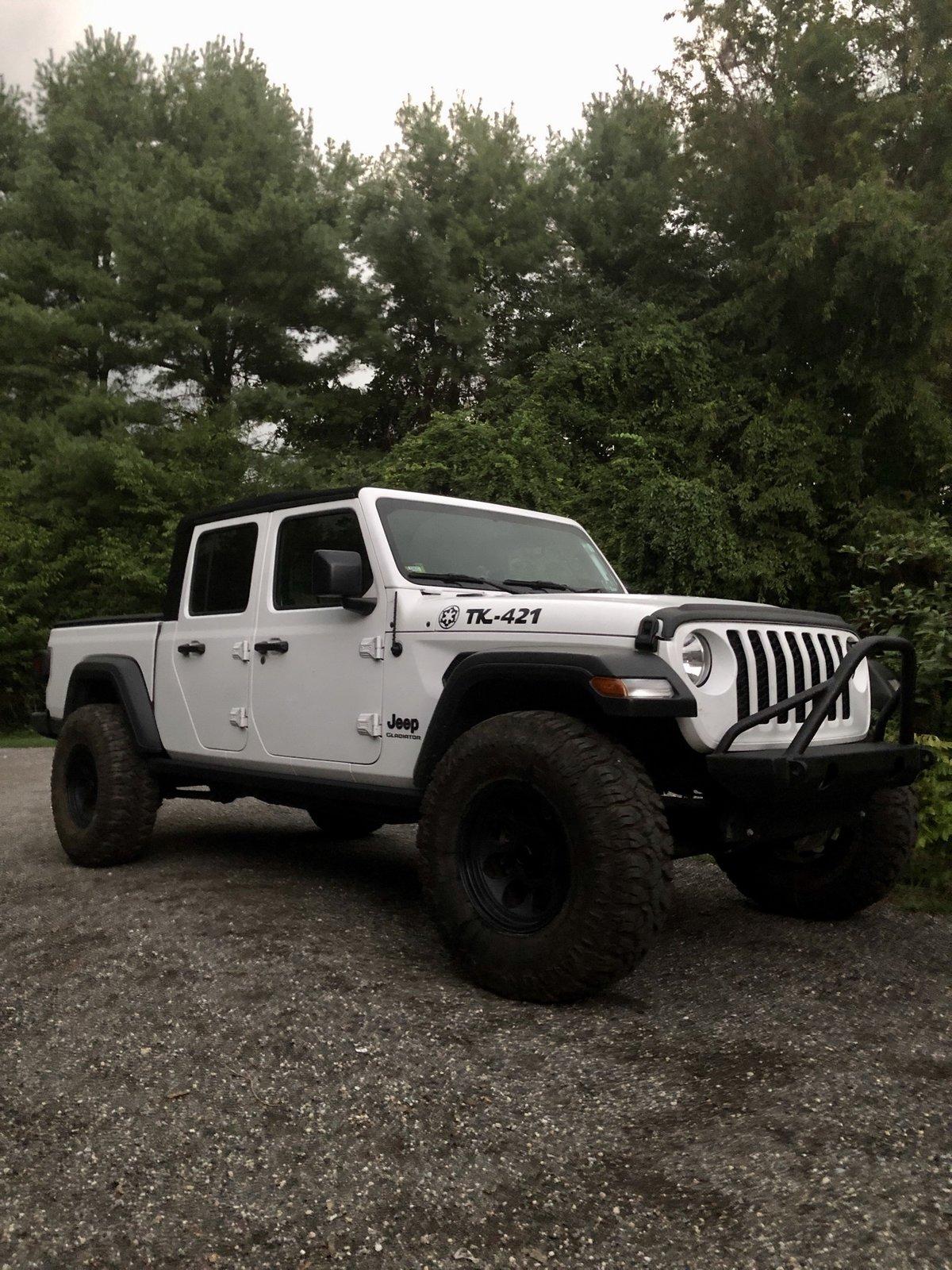

I just picked up a set of 37/12.5r17 Milestar Patagonia MTs tonight that I'll put on tomorrow and update. Sport S, manual, non-max tow, 3.73, Rubicon takeoff shocks/coils+1.5" Teraflex front spacer and .75" rear spacer currently on 285/75r17. All my off-road driving is on soft, sandy beaches. Also planning on 4.88 if 3.73 absolutely sucks.

I'll post some pics when I go out to the beach (because we all know you gain extra hp for posting pretty pics lol).
So far, it is definitely driveable but keep in mind Milestar Pats aren't the heaviest 37s out there. My 285/75r17 Cooper Discoverer AT3 list weight at 58lbs each and the 37/12.5r17 Milestar Patagonia MTs list weight at 71.3lbs each. However, it is true that as soon as you hit any kind of incline/try to back over a curb, it suffers noticeably. Pretty sure I won't use 6th gear unless going downhill. I'm a bit leery on taking it onto the sand now but I'm willing to take a chance for science reasons..

37s on 3.73 with 6 speed? You are brave!
Yeah, I’m not driving too far from my set of stock wheels/tires in case I need to swap back before regear. Most likely 4.88 by the end of the year

Ok, I've put a few miles on these 37s and agree with everyone about 4.88 if not 5.13.
CAN you drive it with stock 3.73 gears? Yes, and mileage didn't suck too terribly. Hills and backing up over a curb reeeaaally suck but is manageable. So ask yourself this, what are you using your truck for? if it's just for looks, i think you can get away without regearing. if you actually want to do truck things, or better yet, Jeep things, you have to accept that you'll be regearing.
As HONCHO recommended, I think Spicer 5.13s are the way I'm going.
