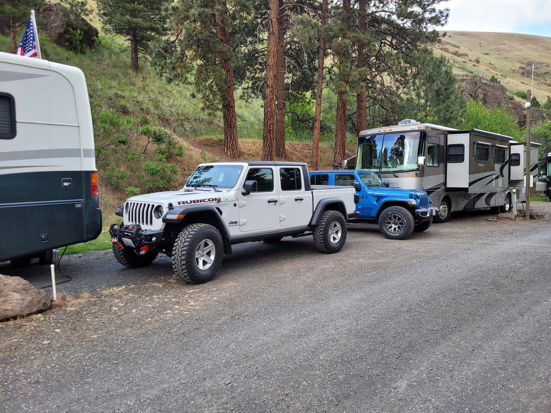

I'm running the Readylift SSt 2.5" lift kit combined with Rubicon take off shocks and front springs on my Max Tow. I added Poison spider geo brackets to the control arms and mine drives and rides amazing. If I wasn't on 37" Goodyear MTRs it would ride better than it did stock. I had a shop install the spacer lift because they only charged me $801 out the door and that included the lift kit and the Alignment and i didn't have the time to install it at the time. I did the Rubicon take off stuff myself and the Geo brackets. If I would of installed everything I would of been under $800 for all. You ain't got to spend a ton of money to have a great ride. Now if plan on banging on a ton of rocks out in the desert then spend the money on a really expensive lift. But if it's a daily that's going to see occasionally light trail use then spacers lifts are great and they allow you to retain pretty close to stock ride.
Jeep Gladiator A case and use for a simple 2"-2.5" lift? PXL_20210328_233737820.PORTRAIT~2
