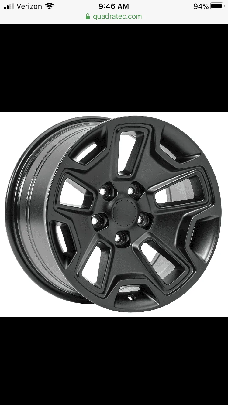

Thanks for the replies so far! I like this wheel. No clue what width tires goes though. I don’t want the tires to stick out past the fenders though. I’m completely lost with all this stuff. Seems like 35’s is the consensus over 33’s? Then I’ll need to research the difference between a leveling kit and lift. I don’t need monster tires. Just want black rims and a more aggressive tire/look.

The more negative the offset the farther the wheel will stick out past the fender. The more positive the more they are sucked in towards the chassis. Don’t quote me but I think I read OEM is around +40 offset Look around a 0 offset to keep them at the fenders. I’m sure other can explain this better than I just did.

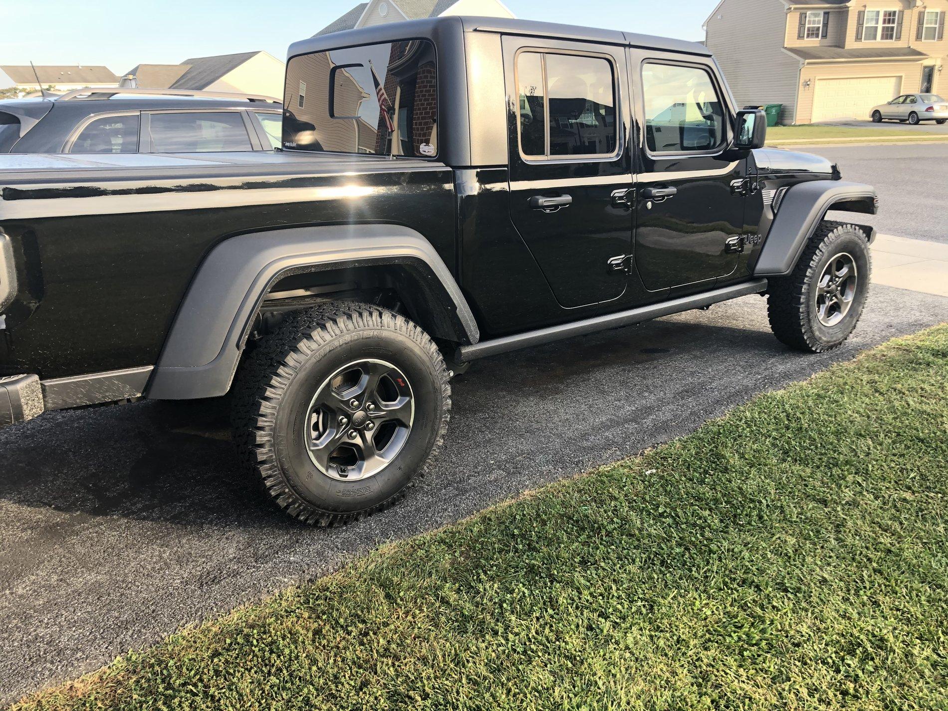

My truck with 285/70/17 on stock rubicon take off rims. It has the 1.5in front spacers and the 3/4in rear spacers.
That's dependent on the both the backspacing and the wheel width as well. It's all one big algorithmic aspect ratio.
