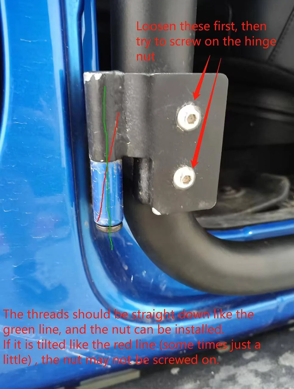

Some customers have told us that the hinge thread is too short and cannot be screwed on with the T50 nut. I would like to explain this here. I hope it can help customers with similar problems.
Let me first talk about the solution:
1. Loosen the two M5 screws on the hinge
2. Put the tube door on the jeep and try to make the hinge thread vertically downward
3. Tighten the T50 nut (that is, the hinge nut)
4. Tighten the M5 screw
The reason for doing this is to ensure that the hinge thread is vertically downward, because the factory considers that customers will adjust the tube door after receiving it during assembly, so they do not align these hinges perfectly, but simply install them.
If the hinge is not perfectly vertical, the nut may not be screwed on. So first use the T50 to align the threads vertically.

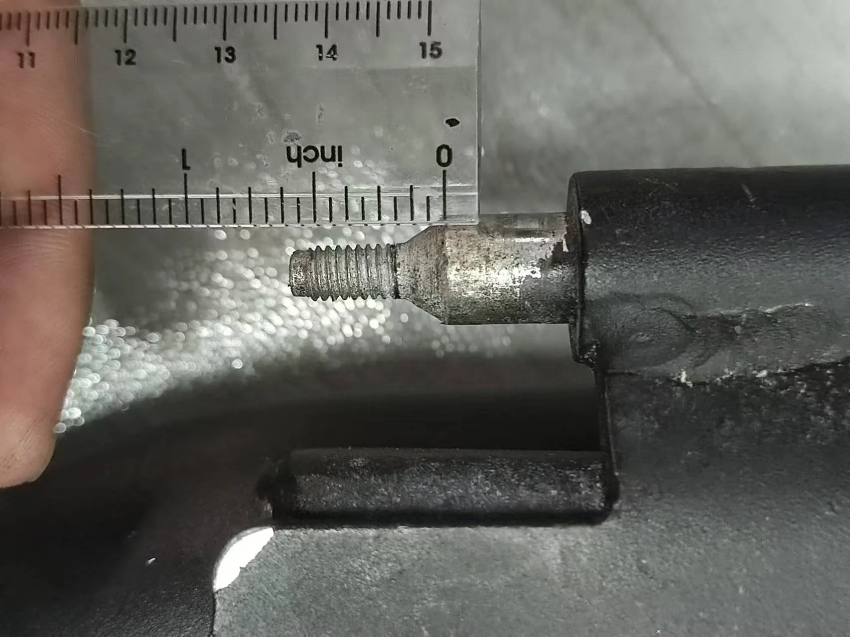

We manufacture these hinges according to the length of the original door (if you check your original door, its hinge thread is also longer at the top and shorter at the bottom).
