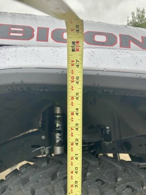

We are running the Clayton Offroad 3.5 inch overland plus lift. I am not sure about before and after with the lift but now its a legit 48 inches to the top of the front fenders. Probably 46 to the top of the inner liners.
Jeep Gladiator Adams 1310 front driveshaft 2E13F69A-297A-4900-ABE1-5526D645E1EF
Wow. Thatā€™s tall. What size tires do you have?
