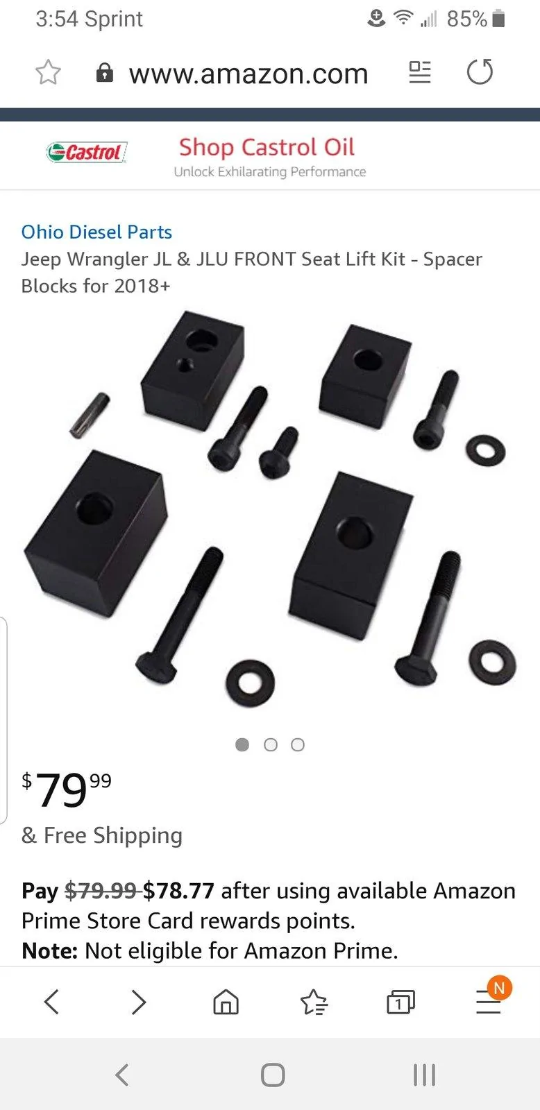

Has anyone ever used the Ohio spacers to add recline to the driver's seat? I assume the JL kit will work on my JT.

That kits appears to be for lifting the entire seat assembly, rather than adjust the incline. I've used a stack of washers between the slider and tub on cars in the past to get some tilt added for the seat. May try that again with the JT.

Are the studs going to be long enough to torque to spec?

I almost pulled the trigger on that kit for my JL. I will likely try using the front only on the JT when I get it. I hate the flat position of the driver seat.

@WXman just installed the Ohio seat lift on the driver's side. Installed per the mfg instructions. There is some increased recline, approximately 1/2 inch. Take care to notice there is a locating pin on the console side front rail. You need to turn the block short side toward the console or it will give you a fit. I'll keep it until a better design comes out that will give me another 1/2 inch or so.

Does it look like you could use the front only? I don't need lift, just more recline.

I tried that. The angle of the front right block prevents this. I got the two fronts bolted down, but then could not line up the rear of the rails to accept the factory studs. This was the option I was hoping to employ here to no avail. Eventually I think someone will come up with a better solution. I may give @megamucho's solution a try. Just a max amount of washers what will allow all the studs to line up and be torqued to spec.

Thank you for that info. That's what I was afraid of. I believe I'm going to attempt to use steel spacers from Lowe's. They sell those in 1/2" lengths and I feel like I could probably use those in only the front and still be able to get the rear studs to line up. Even 1/2" will feel much better on the backs of the legs.
