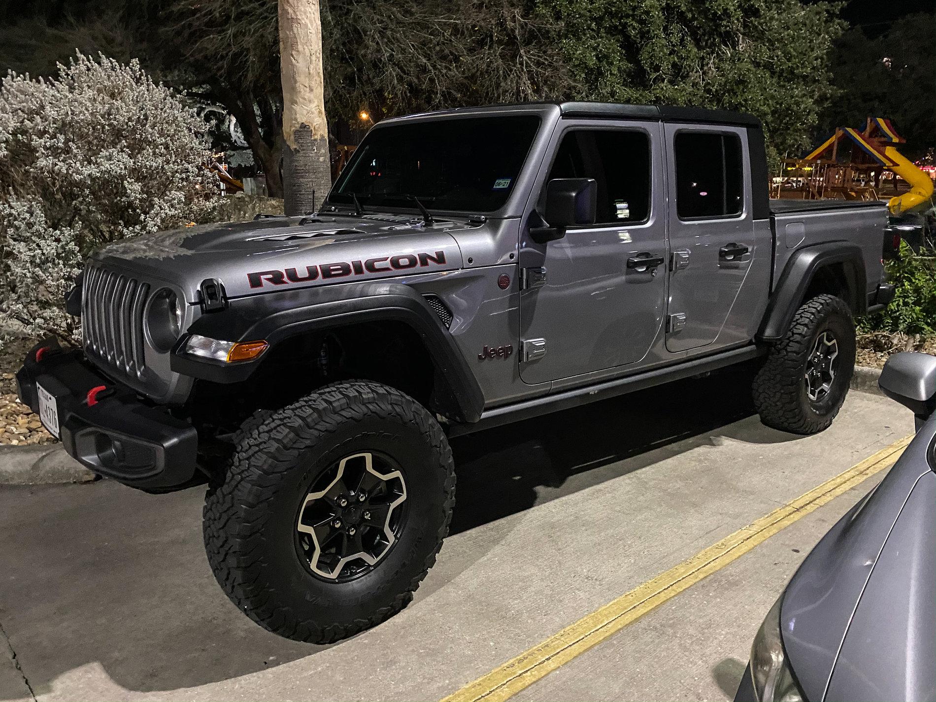

Got myself a MOPAR 2” lift and bought .75” spacers to add. Anyone go bigger than that? Was really wanting 1” but couldn’t find them.
Currently running 37s, no lift.

I don't have any answers for you, but how are the 37s with no lift working for you offroad? Looks great. Any rubbing with the swaybars disconnected?

Zero rub daily driving
Some rub at full articulation but no damage. Some skid marks on the plastic is all.

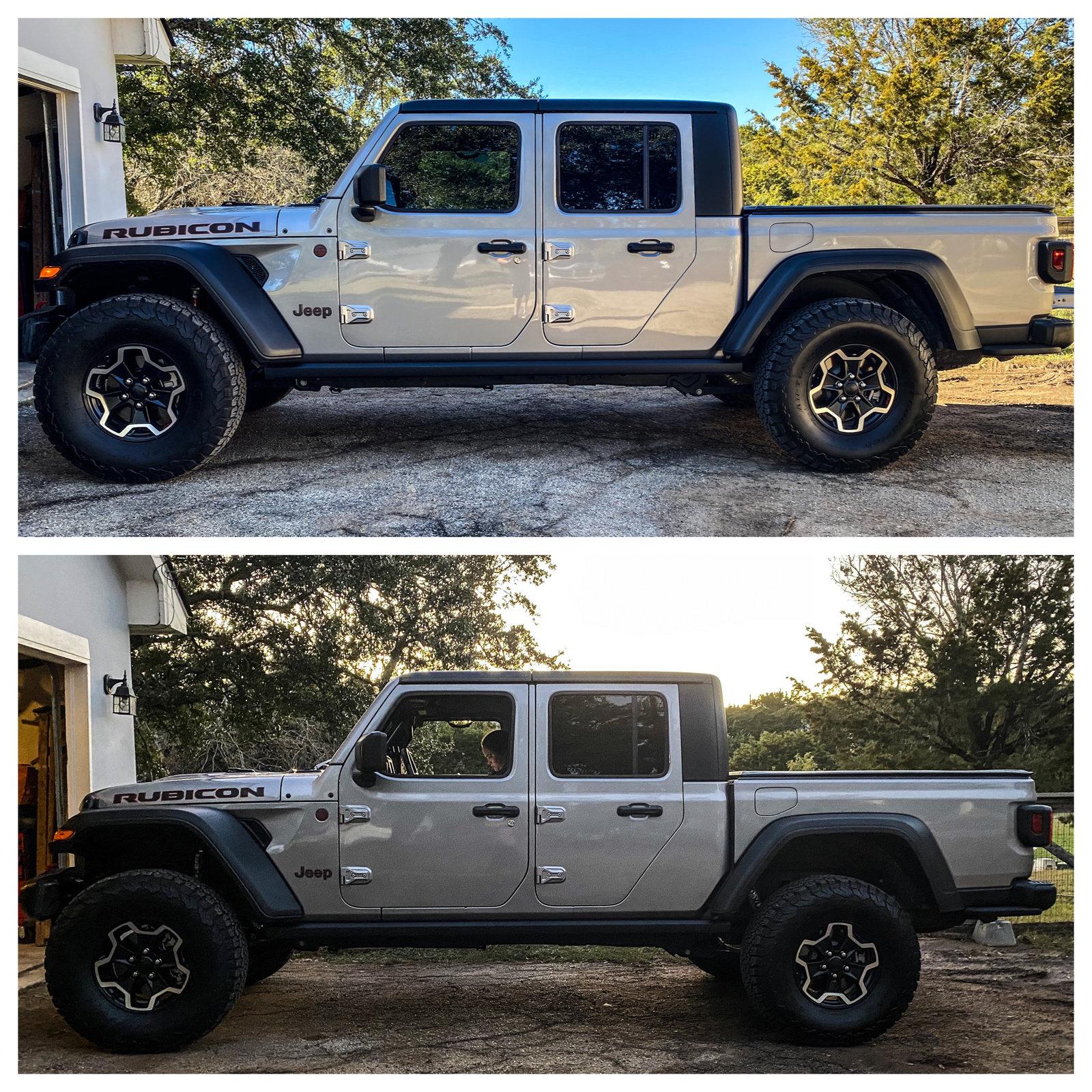

Lift plus spacers is done. Sitting a solid inch higher than the math so I assume it’ll settle.

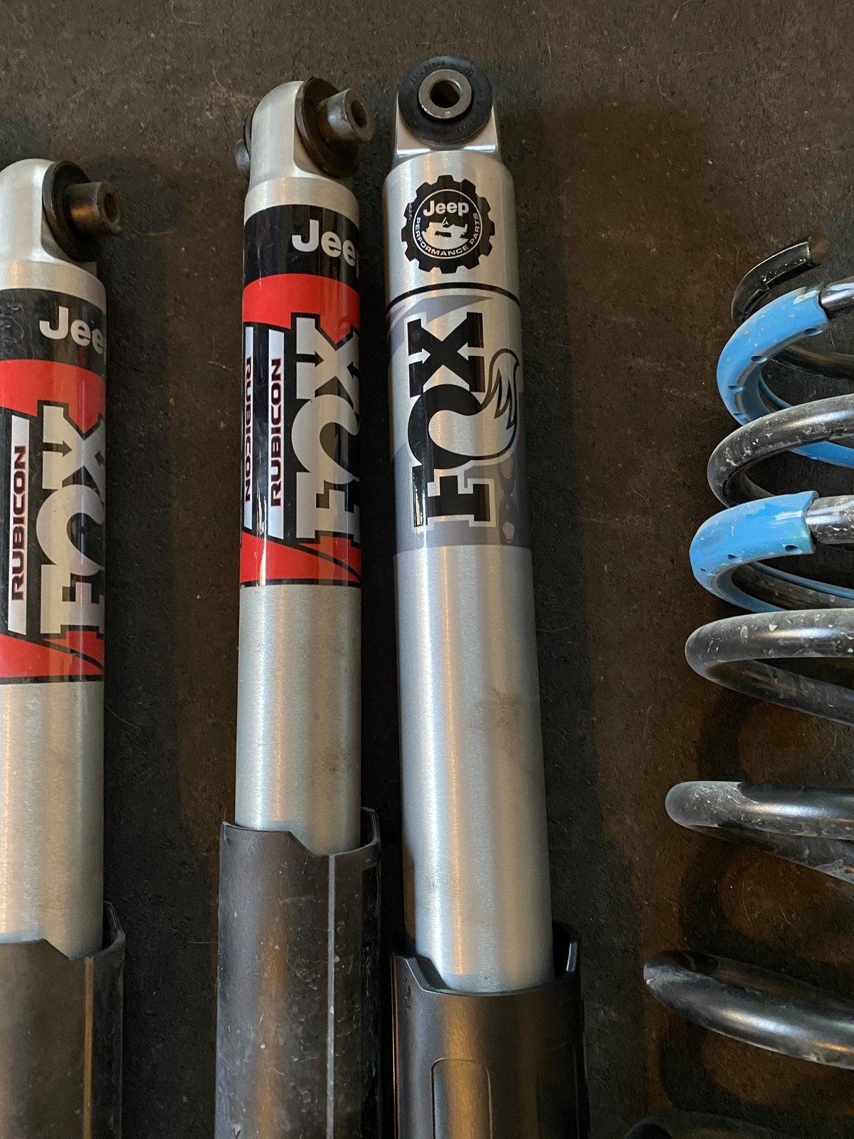

Thanks for the compliment. So far so good. Seems to ride and drive just like it did with the stock suspension. Like you, that’s what I was concerned about and that’s why I went MOPAR. The new Fox shocks are quick a bit beefier too. I’ve only put about 40 miles on it so I’ll know more as it settles but my wife and I agree it rides the same. Definitely not “better” tho. The stock Rubicon suspension rode quite well before too.
Another reason I like the MOPAR now is for the rear springs. Man they’re beefy and the new ones are even more beefier than stock were. So I don’t expect to see any bed sag like I’ve seen with other lifts after putting any weight back there.
I don’t run wheel spacers. DD driving it doesn’t rub at all. With the stock suspension it did rub a little at full articulation but I’m certain it won’t now. I’ll be wheeling again Saturday and I’ll find out. The new lower arms were like 1/8” longer. Not sure the real measurement but laying them next to each other I laughed a bit. It was so small of a difference.
Now after a couple days and a few miles I really like my choices on it. They’re falling in line with a bunch of other peoples similar reviews I’ve read this past several months.
I also feel on my next tires I can easily go 38s, even 40s (that one isn’t happening). I might go 38s tho.
Also worth noting is I sold my Rubicon suspension for 250 bucks within an hour of listing it. Probably could get 300. Worked out well for me since I won my lift at an Xmas Jeep part auction for 850. :)
Steering and tracking. Both axles have been slightly shifted to the frame side of the track bar but you can’t tell. I will monitor tire wear and see if adjustable track bars will be needed or not. But MOPAR didn’t see fit to add them so I’m not worried really. My JKUR has a slightly taller lift and hasn’t ever had any issues there. Tracks and steers just fine.
