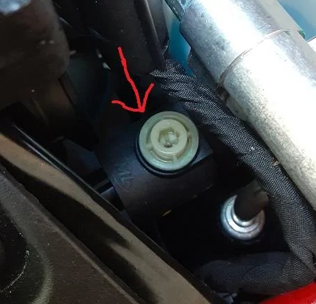

After installing Rubicon takeoffs on my Overland, people started to flash me when I was towing my boat.
So I adjusted my headlights down. Here is how to do it.. Its easy and only takes 5 minutes !
Tools: Screwdriver, Wall
Under your hood , on each side behind the headlights are the adjusters.
Drivers side :

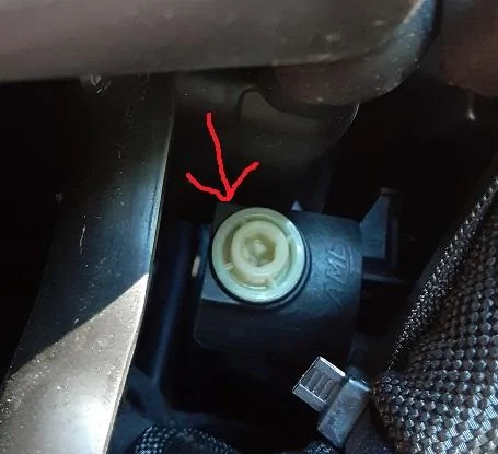

Passenger side :

Pull up to a wall about 15 feet away and turn your lights on.
Put a screwdriver in to each adjuster and turn them clockwise to make your lights go down, counterclockwise to make them go up. I turned mine clockwise to make them go down about 2-3 inches.
I used the brick wall as a guide to see how much to lower them and make them level.
You may have to re-adjust them after driving at night if people still flash you.

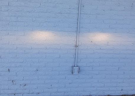

Here is what it looked like after I finished. I came down about 2 bricks.
Jeep Gladiator Adjusting Headlights - How To head3
Its an easy adjustment to make after you lift your truck and wont blind oncoming drivers.

All the other jeep headlight adjust how to videos and others also use a standard 25' feet from wall, and three foot line on wall, I've done my Mojave twice once as the bed cap sagged the rear a bit and I was getting flashed all the time, and again after putting a small spacer lift on to eliminate the sag, lights were too low, used the 25'/ 3' rule and lights are fine.....Jack

The horizontal “aiming” line should be the measurement to the center of your headlights, vertical line should be as well and then center are the proper marks to use.

I have seen this 25'/3' thing several places, and I don't know where that comes from. If your headlight centers are at 3 ft, the beam will be very flat. If they are at 4', the beam will be aimed really far down. Every truck's height is different, so the 3' will apply to very few.
In NC, the law states that the lights should not be blinding to other drivers, but at 75' no higher than 42". If my 48" high lights were aimed per the 3'/25' "rule", they'd shine at only 12" off the ground at 75 ft. I'd be driving blind. So at 48", to attain 42" at 75 ft, I'd aim my headlights to 46" at 25 ft. (48-42=6" drop at 75 ft. 1/3 of 6" = 2" drop at 25 ft)

Followed the 25'/3' rule. Had to adjust them down after a 1" spacer lift and larger tires. 1 full turn counterclockwise = 1" drop

I put Cibie headlights in my XJ, 2 different pair in my JK. The second pair were heated JW Speaker evo J3. The oe LED upgrade is really nice, worth every penny. This 25’/3’ rule May work for some but it’s not the right way.
The horizontal “aiming” line should be the measurement from ground to the center of your headlights, vertical line should be the center of them, that should give you 2 + on the wall. Basically transfer the center of the lights onto the wall.
Much more through explanation http://danielsternlighting.com/tech/aim/aim.html

25/3 would be on a stock JT/JK/TJ but your right you should measure to the center of the headlight to be sure, most of the time on a stock one it's 3ft. After you lift one then you definitely should measure to the center and the 25ft rule applies either way.
Also another thing I would add is make sure your on flat ground when adjusting them.
