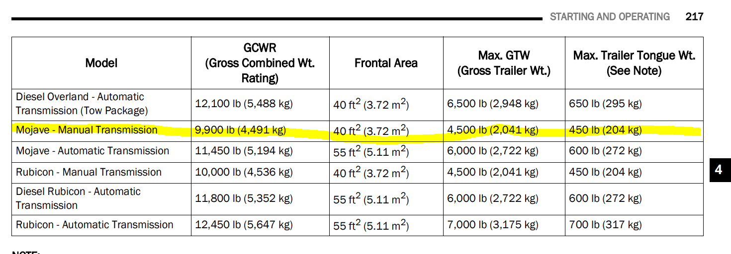

sorry to say this but i think you are a little miss informed. the mojave does have certain components that the max tow has but due to the suspension the tongue weight and trailer weight are lower than the max tow rating. if you have a manual transmission like it says in your profile then its even lower.

Indeed quite different information than I received from the manufacturer. Can I ask your source? because of the "rule of 10%" most publications list Tongue Weight at 10% of Max GTW. This is because of safe weight distributions front to rear over 2, 3 or 4 axles. The use case I am using is different because in total I am carrying only about 1500lbs (Bike, carrier, equipment in the bed and cab). If all of this equipment was in trailer the tongue weight for the same load would ~150lbs. The physical chassis, class IV hitch, and mounting hardware are identical on all the models listed in the table. If you build a Gladiator from the factory the reason you cant build a Mojave with the MAX TOW PACKAGE is because all of the hardware that changes from a base gladiator to one with max tow are all included Standard in the Mojave Edition. The difference which rightly so pointed out by you and others on this thread is that on the mojave the suspension is different and that does affect the tow capabilities. I think the main question to me from this new understanding is what should I do to my suspension to increase my safety margin in my unique use case. Airbags on the rear suspension might be the right answer. I will need to research it some more. Thanks for your help. I would like to know where you pulled that table from, because its different from the one I got from Jeep last Sept when I bought my Mojave.
its in the owners manual. can you post what you got from jeep?
Ill dig it up. I believe they emailed it me. Might not be able to get to it today, but that's definitely not what's in my 2020 owners manual. Do you have a 2021 model? Maybe they updated the owners manual and I'm going off old info?
