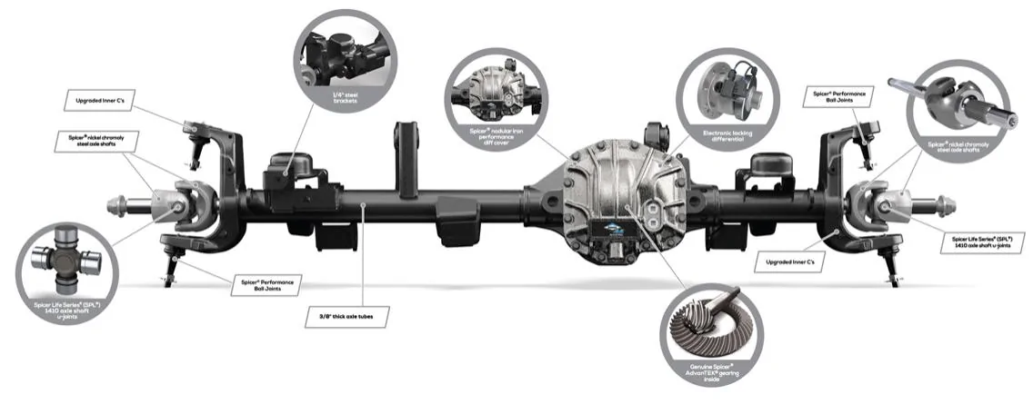

Was just wondering if anybody had installed one, thoughts or opinions. I am going to 37's at some point and I have no need for a front 60. This looks like a nice "go between" option. Thanks!

Isn't that just Dana's aftermarket name for the M210 and M220 axles? I know it's what's going in the Bronco with the Sasquatch package as well.
Your stock D44 will be just fine for 37's but upgrading axle shafts and ball joints and the like is a good strategy. The housing itself will hold up just fine as long as you aren't bouncing it on rocks constantly.

Then buy a thick wall D60 because the Dana-sold AdvanTek will cost you more than the better quality upgrades you'll get out of upgrading the components yourself. The housing is the exact same thing other than the FAD so there is near zero benefit.

That’s the Ultimate D44 Advantek axle. Yes, it should be an upgrade vs. stock.
Jeep Gladiator AdvanTEC Axle 53950E46-E44E-4954-8CBC-0334ECCB176E
would this work if paired with Rubicon rear axle? I’m guessing it is the wider axle like the Rubicon/Max Tow and not like the standard Sport S/Overland.
I’m asking because I own an Overland and along with a lift I was considering either this front axle w/ Rubicon rear or simply adding the RCV ultimate Dana 44 CV axle set (for 32 spline). Initially I was looking at the RCV product but after adding ARB lockers, compressor, etc it seems I wouldn’t be saving all that much vs. buying these axle sets

I do believe that these are wider like the Rub's. I think I am going to just go with a 60 rear instead of building up the 44. I don't think the cost is that much more when you consider the RCV cost.

If you aren't going to do lockers, then I would look for a set of the Max Tow axles as they are the wider axles similar to the Rubicon, have the 4.10 gear ratio like the Rubicon, and would run 37" tires without any issues. The cost of a pair of these axles has to be way below Ultimate Dana 44s or Dana 60s. I am in the process of replacing mine now with Rubicon axles because I want the lockers front and rear.

I have the Max Tow & am looking at upgrading/replacing my axles too... Ultimately though its expensive.
Lockers are like 2000 (ARB RD246 front & rear)
1400 for 35 spline axle shafts front
Unknown for the rear, but I am guessing another 1400
300 for ARB compressor
500 for trussing & C clips
so I am at 5600 before labor & other assorted crap. I am looking at probably 7-8k total. I really dont think I can get any stronger without actually going to a true D60 setup. I may do a 44 front & 60 rear though with eLockers & FAD delete which will cost a bit more. but I dont think a crazy amount more given that the labor is much much simpler.
