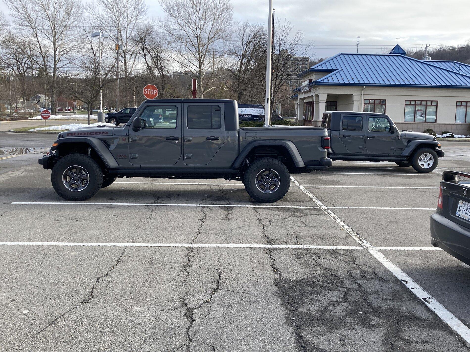

Let us know how it goes. I've got the Mopar lift with a Smittybilt winch in the stock steel bumper, and definitely have a healthy rake. I plan on packing the back and towing a bit, so I'm not that worried, but I'd love to see how it looks with the 1/2" level and whether that turns our to be hassle free over time.

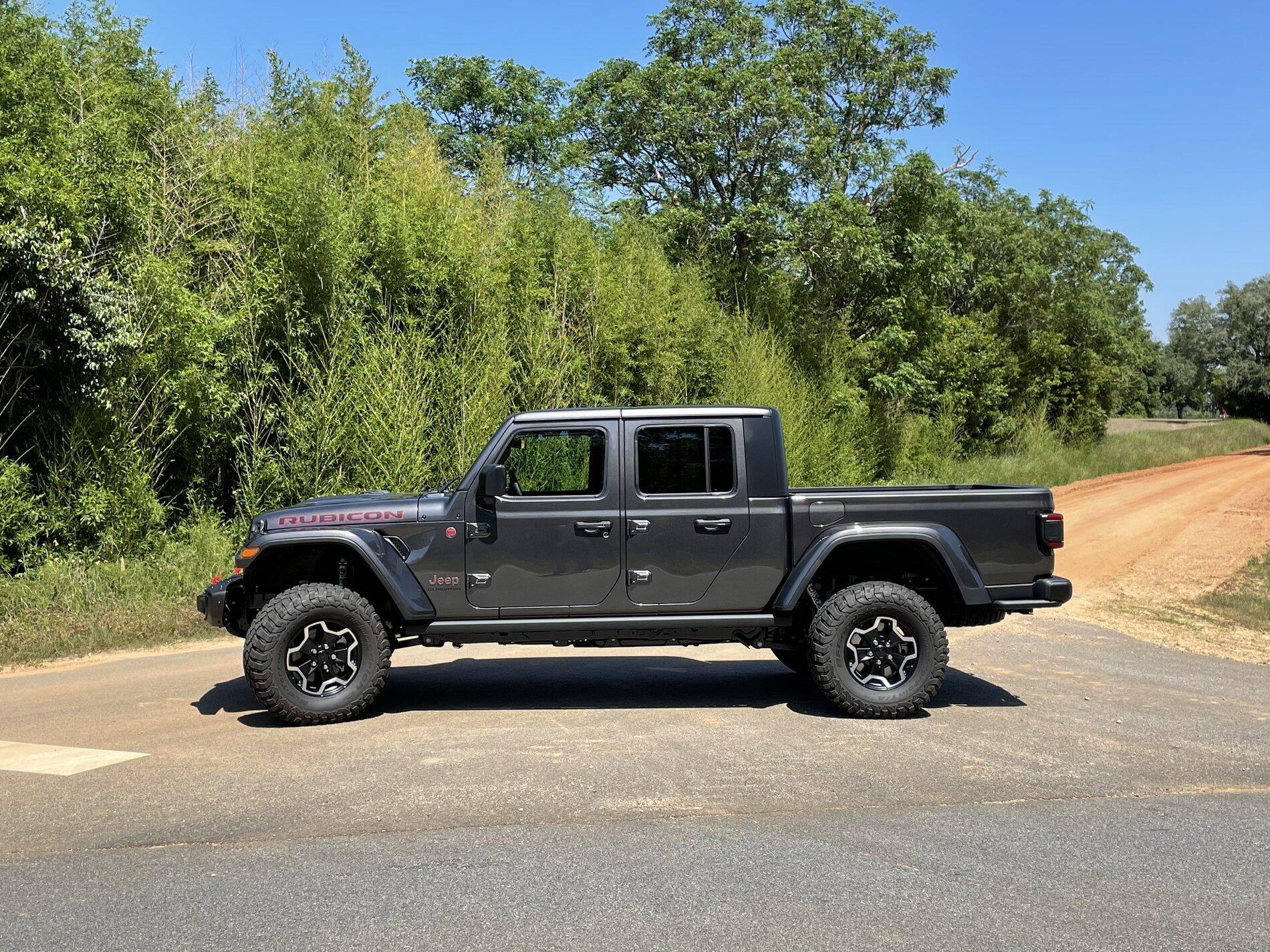

I like the results!
Jeep Gladiator Advice on 1”-1.5” Level Kit with Mopar Diesel 2” Lift 899794D2-576D-461D-BC68-FDB1952E9A57
Still has about an inch of rake, but looks great to me! Ready for the 37s now...
