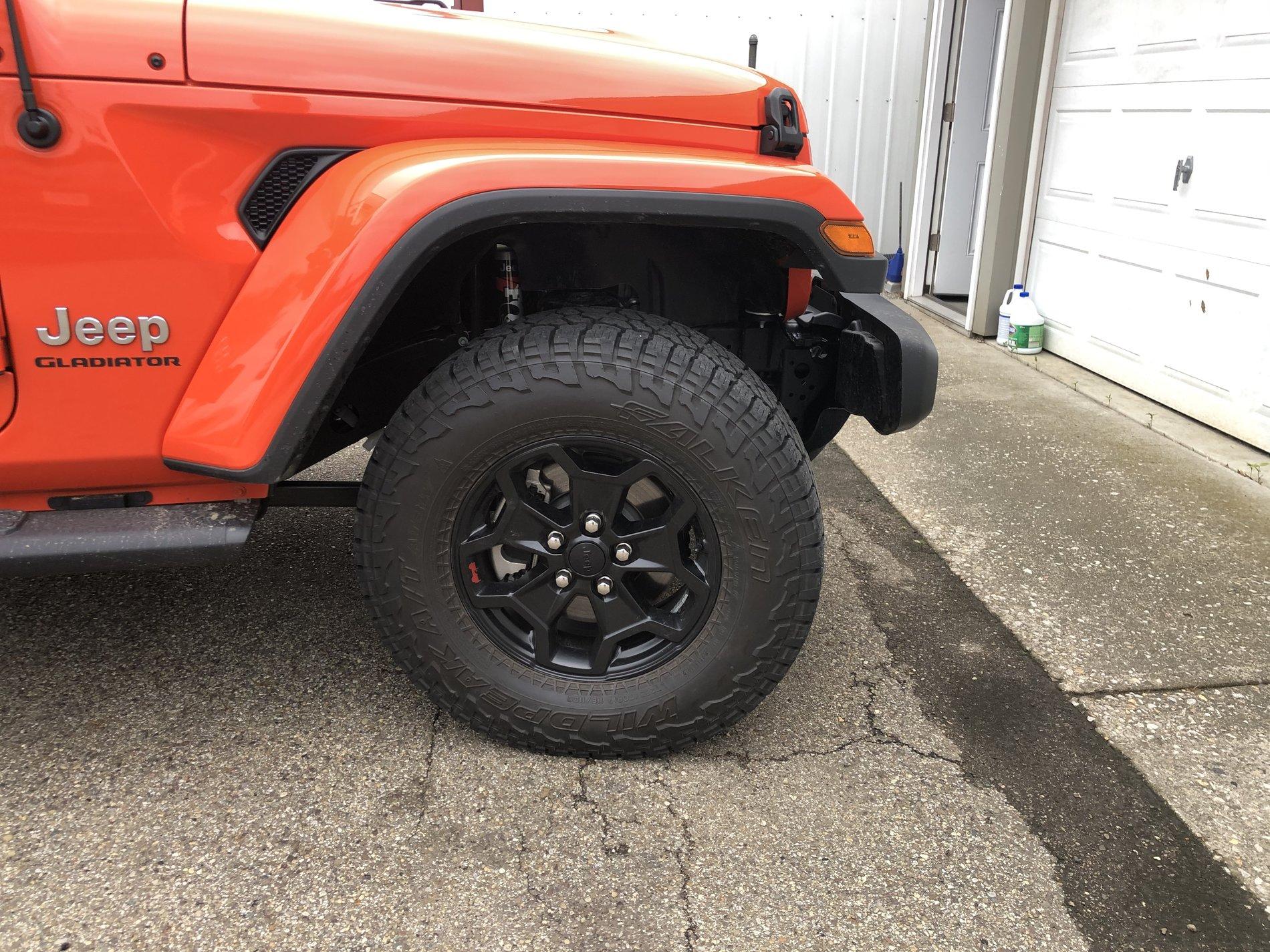

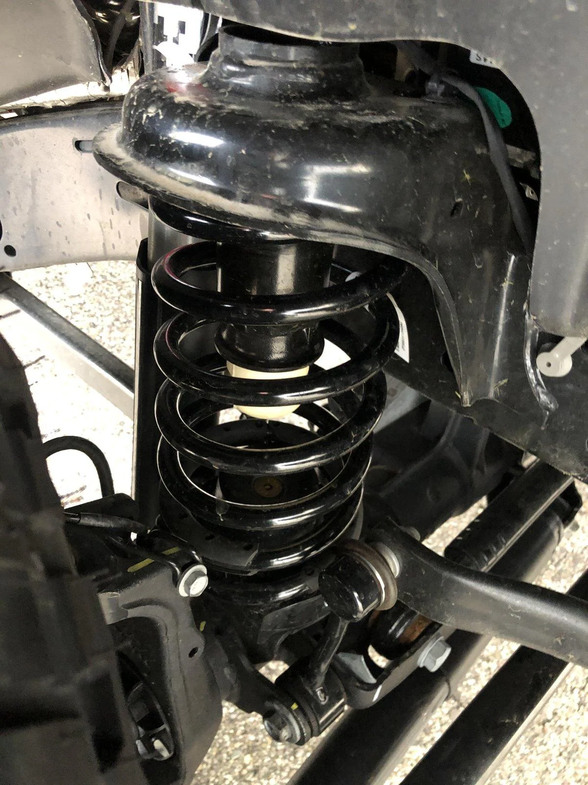

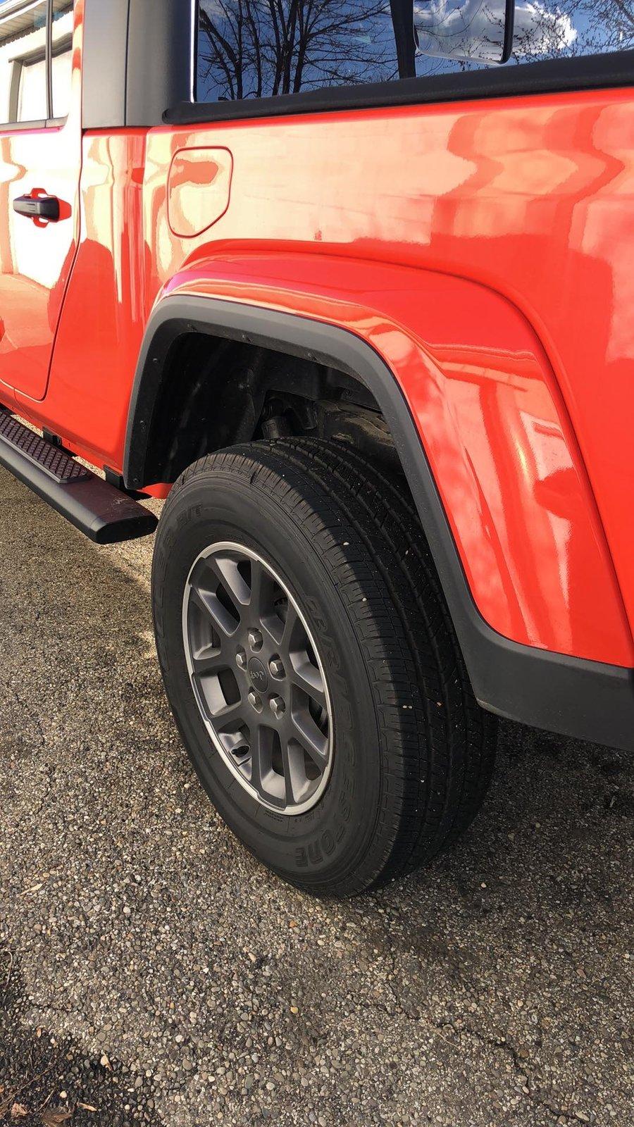

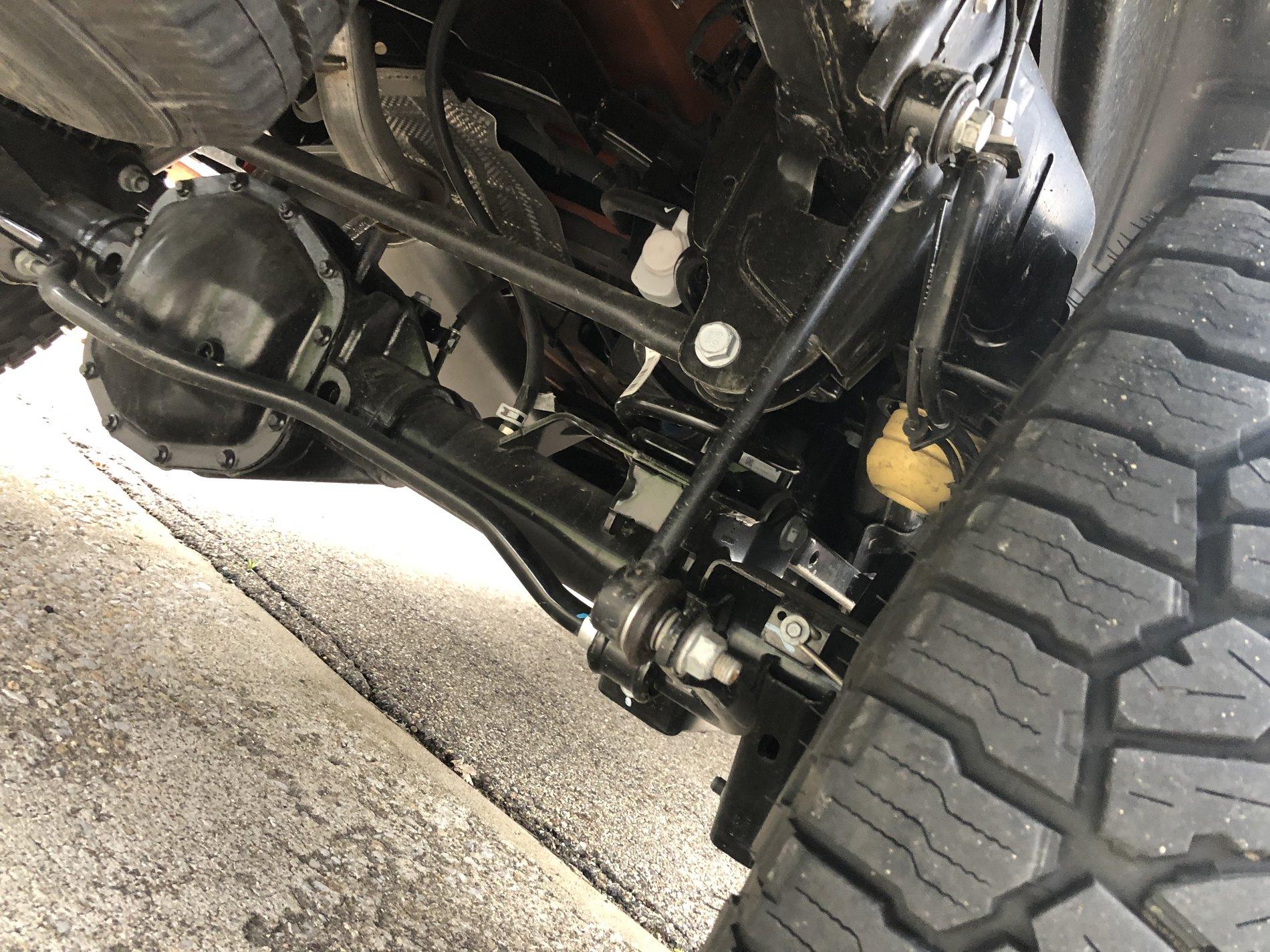

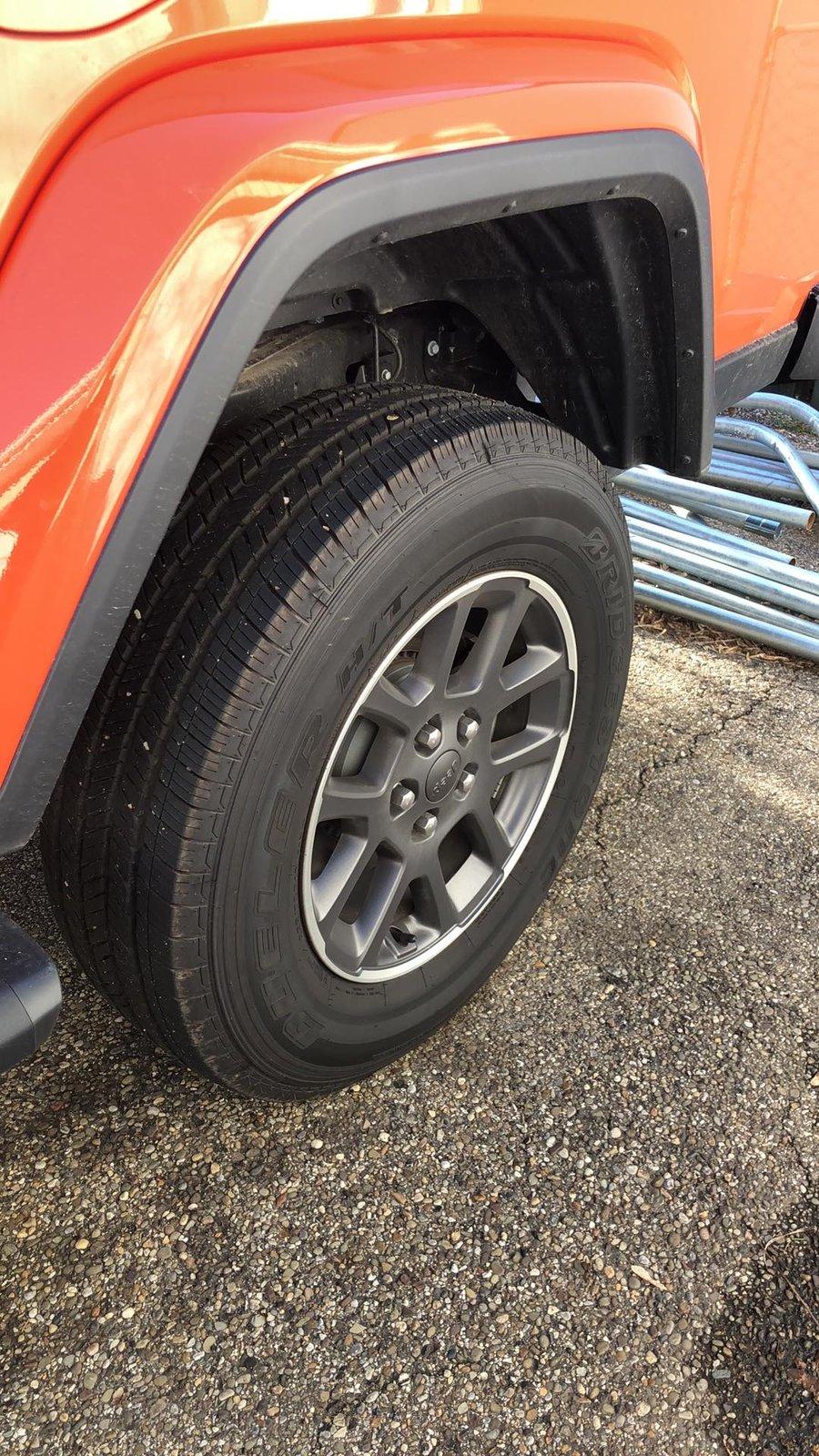

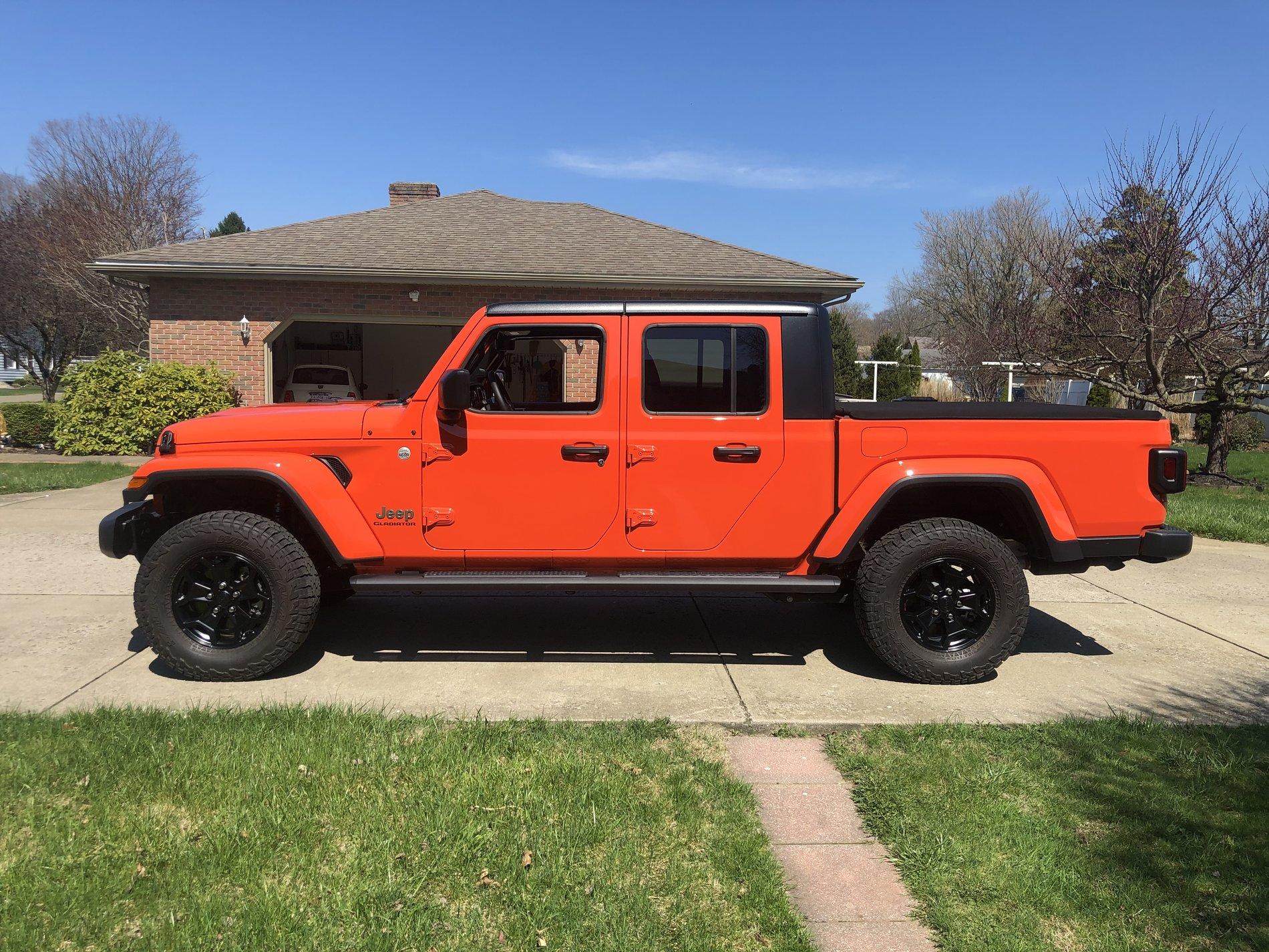

Lenny351
Feb 29, 2020
Ohio
2020 Gladiator Overland
Electrician
For what it is worth I installed Rubicon Springs on my overland and it gave me exactly 1.25 inches of increased height. I then added 1 inch front spacer to level it out but for me the Rubicon springs definitely raised the truck .
teleportJeep
Marco
Mar 31, 2020
94
126
San Diego
gladiator
Besides the springs and 1” spacer, any other suspension parts change?
Can you share some pictures.
Thanks
Mar 5, 2020
1,954
2,404
Lake Martin, Alabama
So, stock factory Rubicon springs ARE actually 1.25-1.5" taller than the other model JT's? That's what I thought...But was told I was wrong. Good info to know.
