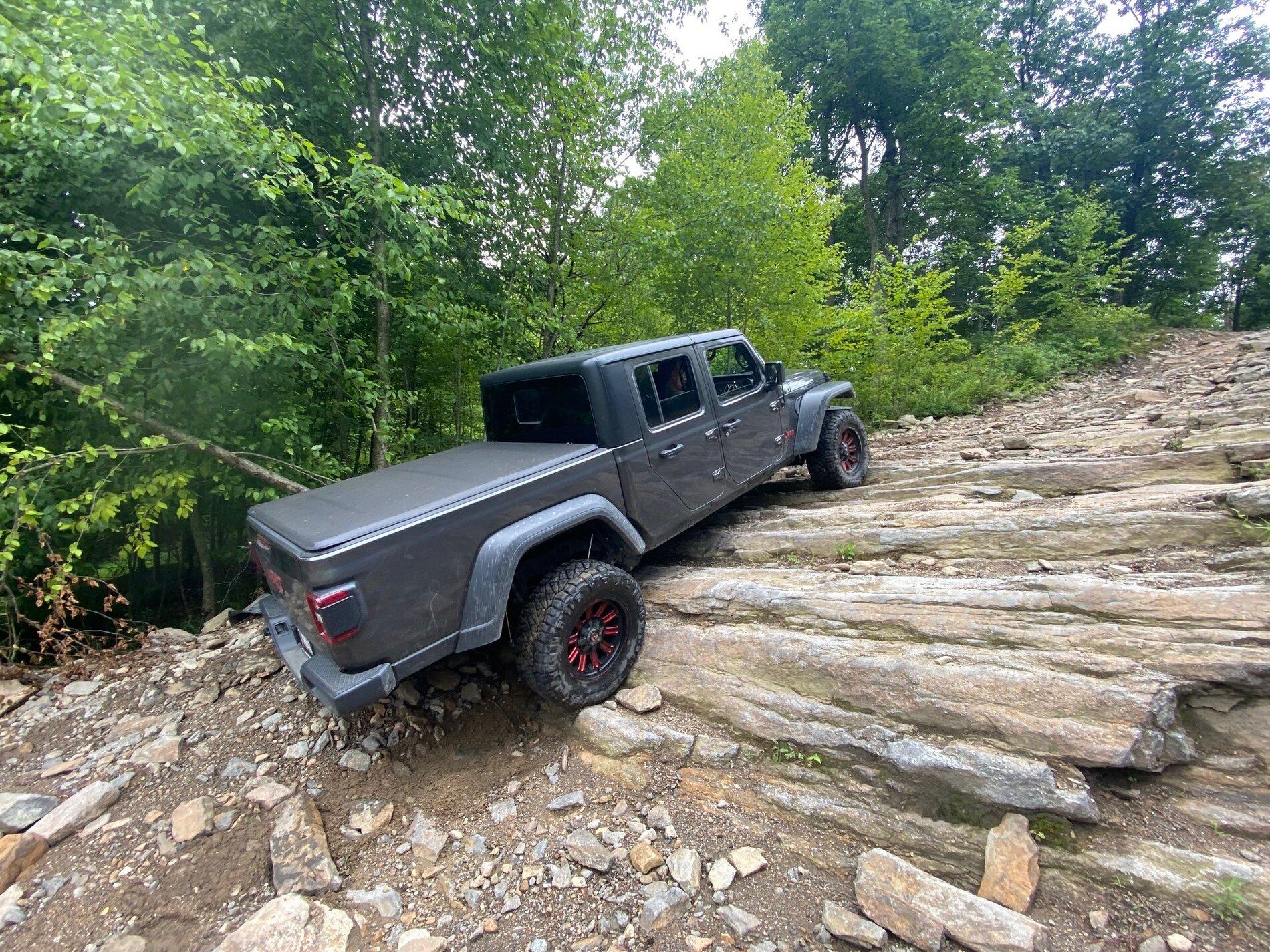

(Photo to show I have actually been out wheeling and learning. Just looking for other ideas or confirmation)

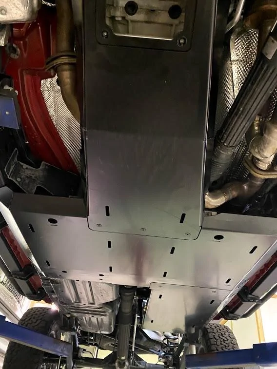

If your wheeling then don't bother re gearing without installing lockers. And before I had my lockers I found that the best upgrade I had to allow me to follow the bigger badder rigs was a full skid plate. I would scrape from one end to the other, but give zero eff's about it. That let me use a bit more skinny pedal and momentum to get over where even taller JT's with lockers couldn't/wouldn't go. Simply put I could abuse it with no worries about ripping the underside out.
Gas tank skid is missing in the image below.. But you get the idea of what I got under there.. This is the Motobilt skid system.

Yes the motobilt skids are heavy. But also very low. I do recommend them if your going to put them to use. I decided on the motobilt skids because they are the only ones available at the time that covered full length on both sides and were smooth. So you can skids off of stuff. Others have sharp edges on the skids which could create more issues with getting hung up.
