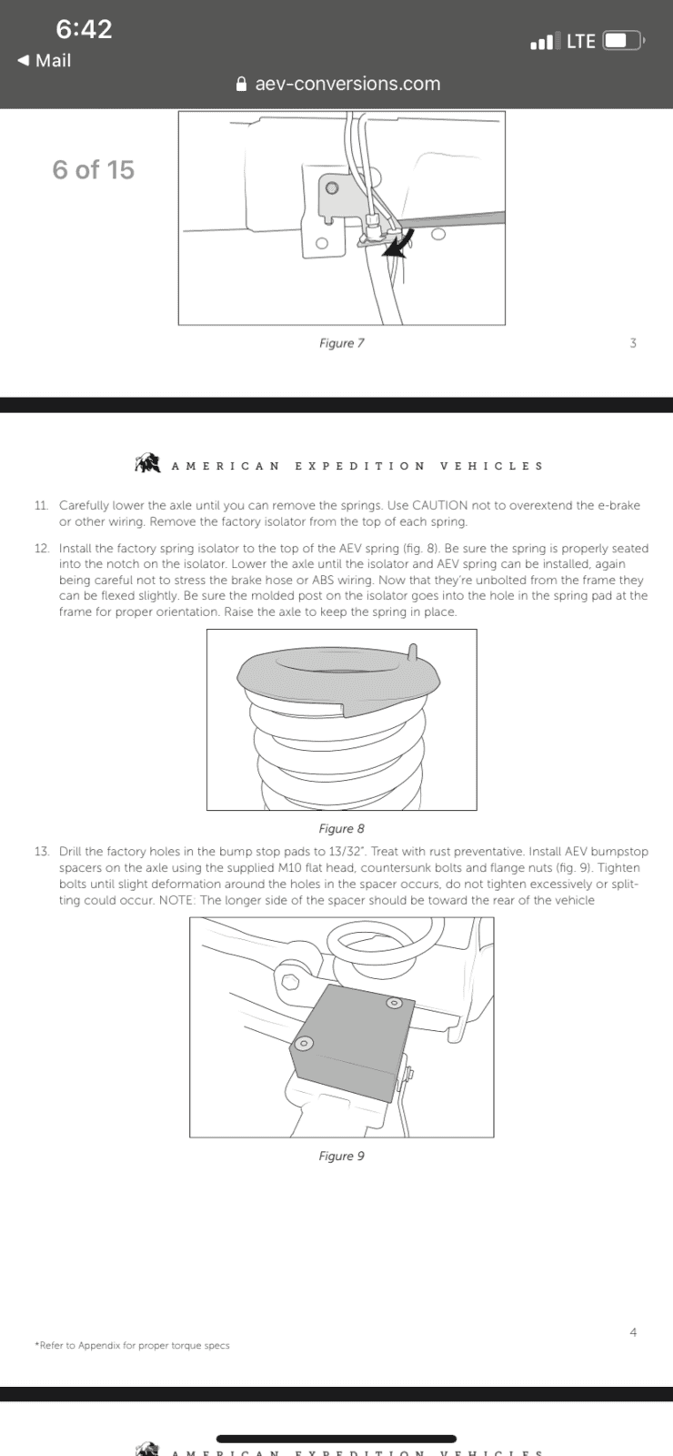

Wondering if anyone has installed this? Does anyone know the big difference between this and the Mopar Diesel lift?

Hmmm interesting. To bad it's not a straight bolt on like Clayton's. I see on the tools list drill and a 13/32 drill bit.

FYI. Not drilling into your Jeep just. The bump stops. Very simple install.
AEV Lift Link
For $400~$500 more than the mopar lift, you are getting 1/2” more lift, geometry correction brackets, and the procal.
All pretty worth it. If I had waited another month or so, I’d probably have gone AEV.
AEV Lift Link
I have it for my gasser. Good solid kit. Does great offroading. But just like the Mopar you need to buy an adjustable front track bar. And it’s closer to a 3” than it is a 2.5”. For the gasser anyway.
