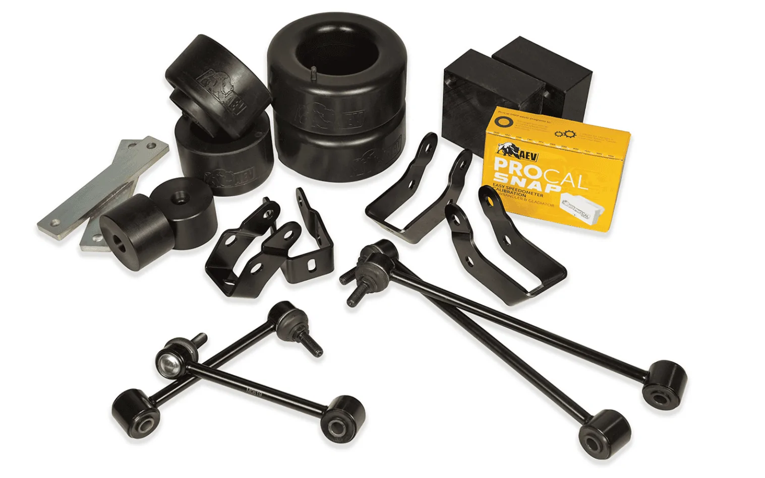

I installed the AEV 2" Spacer Lift. Priced at $449 its rather inexpensive. It's a pretty easy install and it's very complete...until you get to instructions for connecting the Pro Cal Snap module. Fortunately someone created a nice YouTube video showing how to hook it up.
The lift is a pretty straight forward install. They even include some metal plates to drop down the REAR DRIVE SHAFT PILLOW BLOCK which keeps the rear drive shaft angle where you want it.
My only issue with with the lift is the POLYURETHANE SPRING SPACER BLOCKS. AEV has you remove the MOLDED RUBBER SPRING ISOLATORS and insert the SPRING SPACERS. Plastic is NOT rubber and as a result when driving over bumps you often get a little rattling (plastic against metal) that wasn't there before.

I am attaching a photo of what is include in the kit and the instructions if anyone is interested.

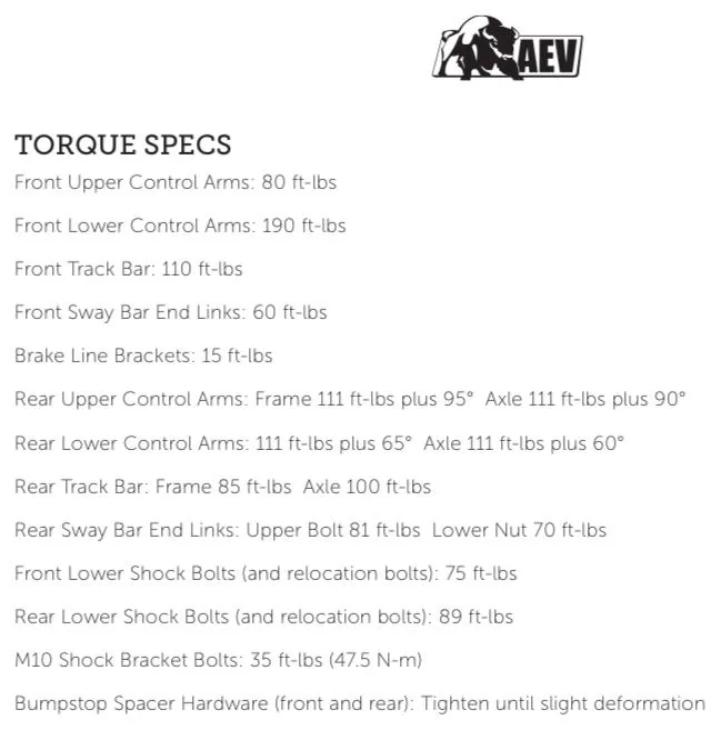

I recommend double checking the lower control arm bolts for proper torque. 190 ft-lbs is no joke and if you don’t get all the way there that could be the source of your rattle. Ask me how I know….

The rear LOWER CONTROL ARMS are specified for 111 lbs of torque in the attached AEV instructions. Unless your saying the instructions are wrong. 190 lbs of torque seems really high for any suspension bolt.
The rear lower control arms are torqued to 111 ft/lb + 60 or 65 (depending on end) degrees of bolt rotation. That puts them around 190 ft/lbs. If you didn’t add that, you are way under the specified torque. I don’t think anyone here is trying to suggest that a poly spacer is “better” than a rubber spring isolator, but the poly spacer is not likely to be causing your rattle. That poly spacer provides plenty of cushion for the spring, and it is always under enough spring tension to keep it from moving around. Also check the spec on the uppers if you didn’t catch the added bolt rotation after the initial torque. The rear uppers should be 185-200 ft/lbs depending on end.
