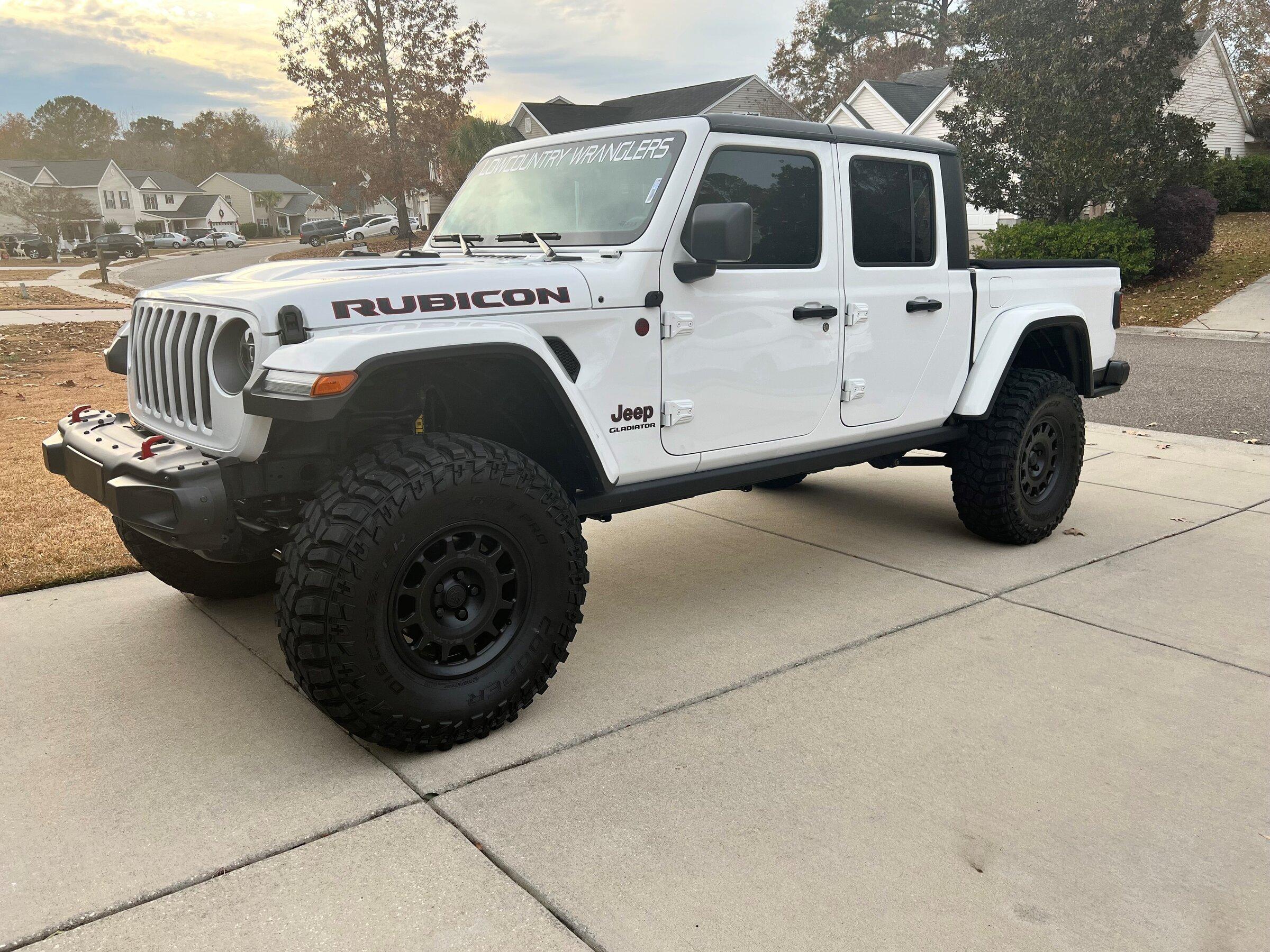

So I forgot to add that I did also replace the rear brake lines. At full droop I wasn't comfortable with how tight they were.
I have Metalcloak adjustable trackbar up front. I currently have a gifted Evo in the rear. I've got a Metalcloak waiting to go in at some point. I'm still trying to decide if it's worth it or not to replace control arms. If I do it'll be with, you guessed it, Metalcloak. Why didn't I just go Metalcloak from the get go? I don't need that insane amount of articulation and didn't want to buy a new front driveshaft. After taking it out a few times I would like a little more flex that Metalcloak's duroflex joints would provide.
I went back and checked the measurements I took before and after. 3" increase at the front bumper, 3.25" increase at the rear bumper. Here's what mine looks like with 37s.

Yeah I hear alll day every day metalcloak is the way to go because their bushings are amazing. Haven't seen them in person but that's probably the way I will go as well. Some day I will get their components for the TJ too. But, to my understanding the reason AEV does the brackets is to negate the need for new control arms. I get doing trac bars of course (and brake lines - which ones did you go with?), but what benefit does adjustable control arms give if the brackets from AEV allow for correct geometry in the first place? Maybe the brackets get the geometry 'close' but not the sweet spot?
Your rig looks awesome!! Its interesting your even pushing over 3" in the rear. What springs did you opt for? The regulars, or the HD's? Kinda looks like 35's will be needed.... 33's would probably look funny given how yours sits on 37's. Looks like I will have to for sure get a side step first before a lift/tires.
Metalcloack control arms for the sake of their flexibility vs stock. The geometry correction brackets work great with the stock control arms though. Brake lines were of course Metalcloak 🤣 (my club is a big fan of them and our shop is a dealer and gets them for a good price). I've read somewhere that the AEV is targeted towards overlanders so they give you a little more lift than advertised for when you load it down with racks, rooftop tents, and other heavy overloading stuff. Measurements taken when installed, things could have settled by then, haven't taken any measurements since install. Those are regular springs, I ordered/installed a few months before the HD came out.
Jeep Gladiator AEV Dual Sport Lifts - what else is needed jeep-jpg-
With it being slightly over 3" up front did you not need a new front drive shaft?
