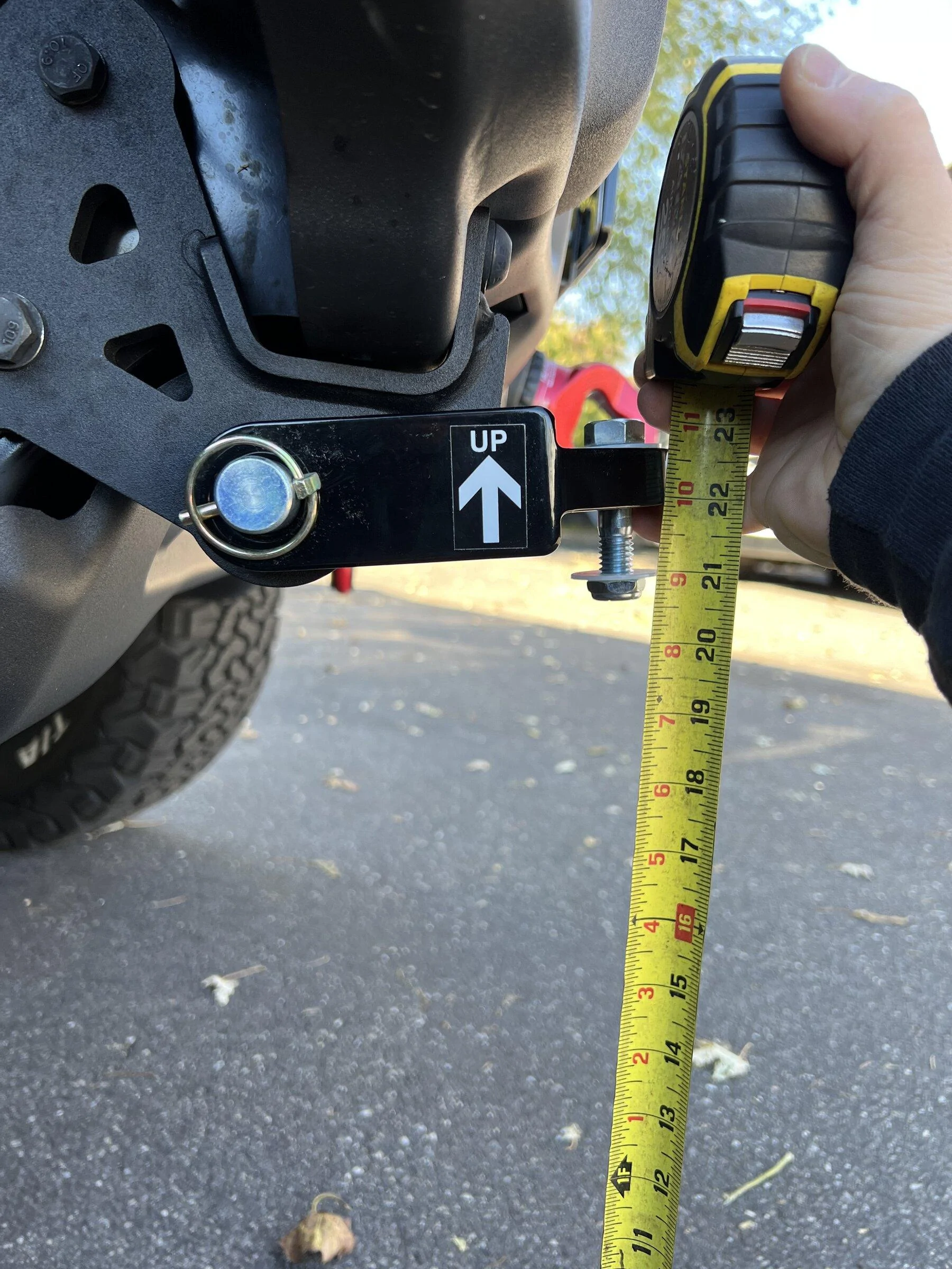

Unfortunately it will not work because when the adapter swings upward, as would happen when pulling in or out of a steep driveway, the adapter makes contact with the bumper. Since there is nowhere for the adapter to go, something has to bend. I have bought the blue ox and roadmaster adapters, same issue with both.
I have designed new shackle mounts and prototypes are being made as we speak. They will replace the entire aev mount and allow the use of any adapter.

Here is a picture of the blue ox hitting the bumper

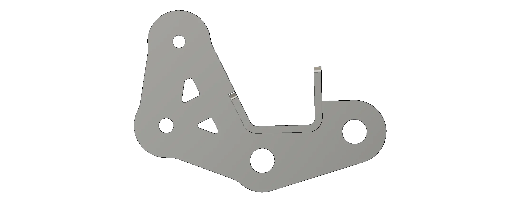

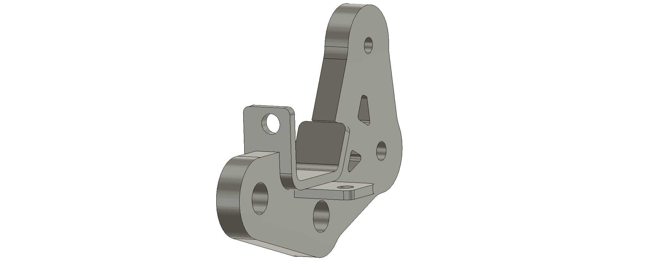

I was told that the Blue Ox would also work after speaking to the NE AEV rep before buying the JT370 and also tech support at AEV. I purchased the Blue Ox adapters and quickly found out it didnā€™t work. Calling AEV back to tell them they were wrong I also spoke to the parts department to order a replacement tow hook to get dimensions and that worker said that he knew the Blue Oz didnā€™t work. Seems like he is the only person there that knows.
Here is the design that was sent to the fabrication shop for the first prototype. The news mounts will be 3/4ā€ thick.

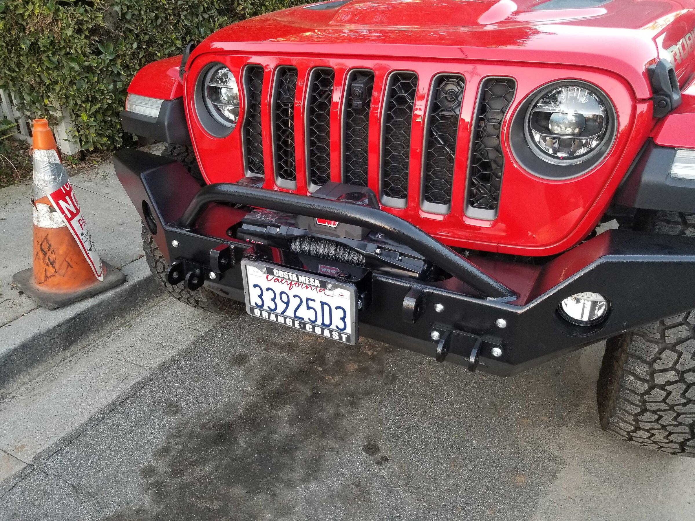

I bought a rock hard engineering aluminum bumper. they sell steel as well. the have mouts that bolt to the frame for all the tow bar manufacturers
Jeep Gladiator AEV RX front bumper flat tow solution! 20210301_070512

I like your design with the increased thickness. I would like to solve my problem similarly. Would your fab shop send me a pair if I contacted them?

sorry for the delay. this is from rockhard Engineering out of Nebraska. just tell them what tow bar you have. I love the aluminum bumper. the tow bracket bolts to the frame. it fits the factory fog led fog lights. I am running a Putco light bar that handles the turn, running, and stop. super bright. I also put in side marker lights. no connection to the OEM circuit.
