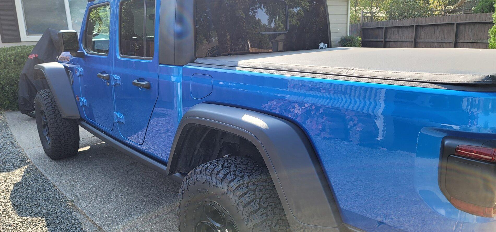

I just bought a set of Savegre IIs, don’t have tires on them yet, the offset I believe is the same as the ones you are looking at which is +25, stock wheels are +44, AEV wheels are 8.5” wide vs 7.5”. I am going with either 285/75/17s or 35/11.5/17s in the next couple weeks.

Thanks for the pic. Oddly, that looks to stick out about the same as mine with -12 offset.
I may need to go with a 35"x11.5" or even 10.5" to keep them under the fenders.
