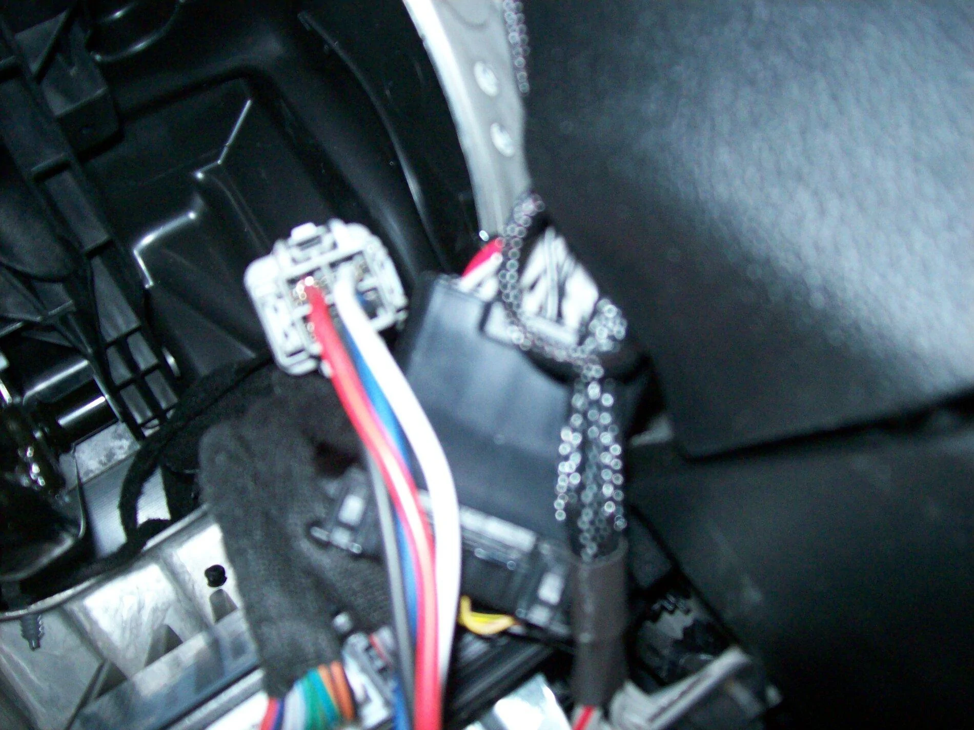

Mine was built in May 19 and did not need a flash. Also my connector was an empty grey one, like this photo with the Curt harness installed for my Curt controller. Last year you had to buy the Ram harness for $8-10 and swap the black and blue leads in its connector going to the truck. I spent under $50 for both harness and controller.
