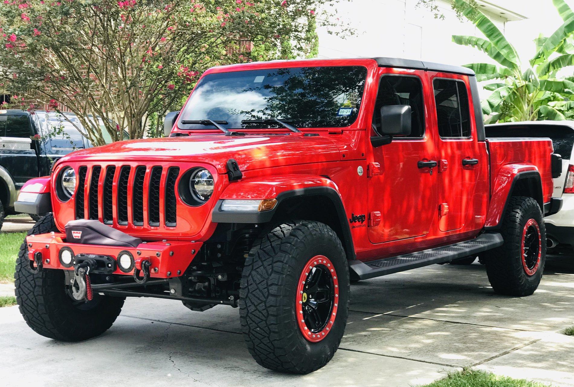

I went with the Smitty XRC and their X20 10,000 lbs winch with Syn line
Like this a lot! Did you install the winch before or after bumper installed?
