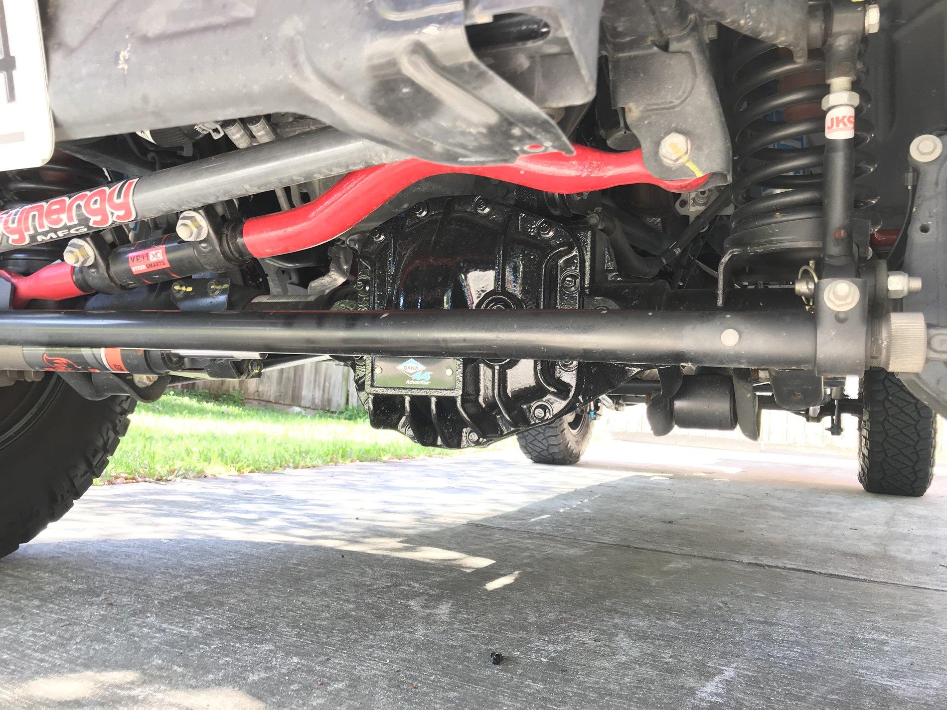

i have the Dana Aventek diff covers the reusable factory gaskets are reusable and work great.

Anyone know if the factory bolts can be reused with the Dana covers? I just ordered front and rear from Summit Racing and only one came with the provided bolts 🙄
Wondering if I can just reuse. I can compare the factory ones, but I’d rather tackle the job in one go, and don’t want to find out I can’t.
Hootbro
Apr 13, 2019
6,388
10,622
2022 Gladiator Rubicon
If the grip length is there you can reuse the factory bolts. My only recommendation is the torque spec is 30 ft-lbs but I would back off a couple of pounds as they have been know to snap the heads off at the full 30 ft-lbs spec. That is also with a dry thread so if you put a liquid locktite compound on the threads, that will affect the final torque even more.
