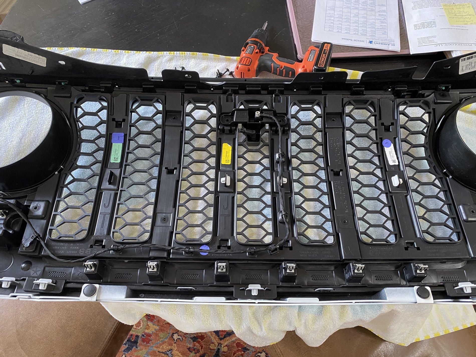

I took my Trail Cam out and unhooked the wiper fluid and power/output harness when I PlastiDipped my front grill.
Other than the factory interface and ability to clean, there’s about $10 worth of parts involved.
Looks like a cheap camera with a cable ran to the AV system and a port for the wiper fluid.
I can tell you Jeep is making an amazing margin on the option.

The harness for power/output comes out just under the drivers side headlight.
The washer fluid connection is just behind the camera.

Hey Keller, I know this was a few months ago but did you happen to see how the fluid was routed? Is there a separate motor or is it tapped off the main fluid?
