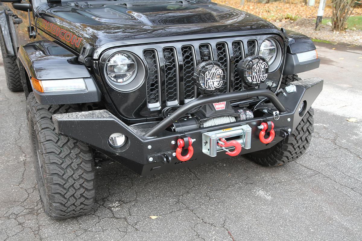

I prefer the lower mount. The Rockhard bumper that I use is the https://www.rockhard4x4.com/product_p/rh-90211.htm bumper, which has the lower winch mount. They have stubby versions as well. That keeps it out of the radiator's air flow so that it won't impede cooling. Also, if you do need to winch your vehicle out of a "stuck" condition you will most likely want to pull up, rather than down, to lift your vehicle out of the mud or whatever. A lower winch mounting position is better for that.
I didn't go with synthetic. I stuck to steel cable. Synthetic is nice but it doesn't hold up to the sun like steel does and will degrade over time. You don't want to finally need to use your winch and find out that the line has dried out and won't hold up. If you use it frequently, synthetic is great but for my rare use I prefer the longevity of steel cable.

Do you have a view with trailcam?
I like this bumper!
Thanks
RVcruzer
Mark
Nov 6, 2019
45
54
Sheboygan, WI
2020 Gladiator Rubicon, 2012 Wrangle Unlimited Rubicon
I like this bumper!
Thanks
No, I don't have a shot of the trailcam view. But without the lights the view is just as if the bumper isn't there. With the lights I get a good shot between the lights but the lights do bracket the image. It is still a useful view with the lights.

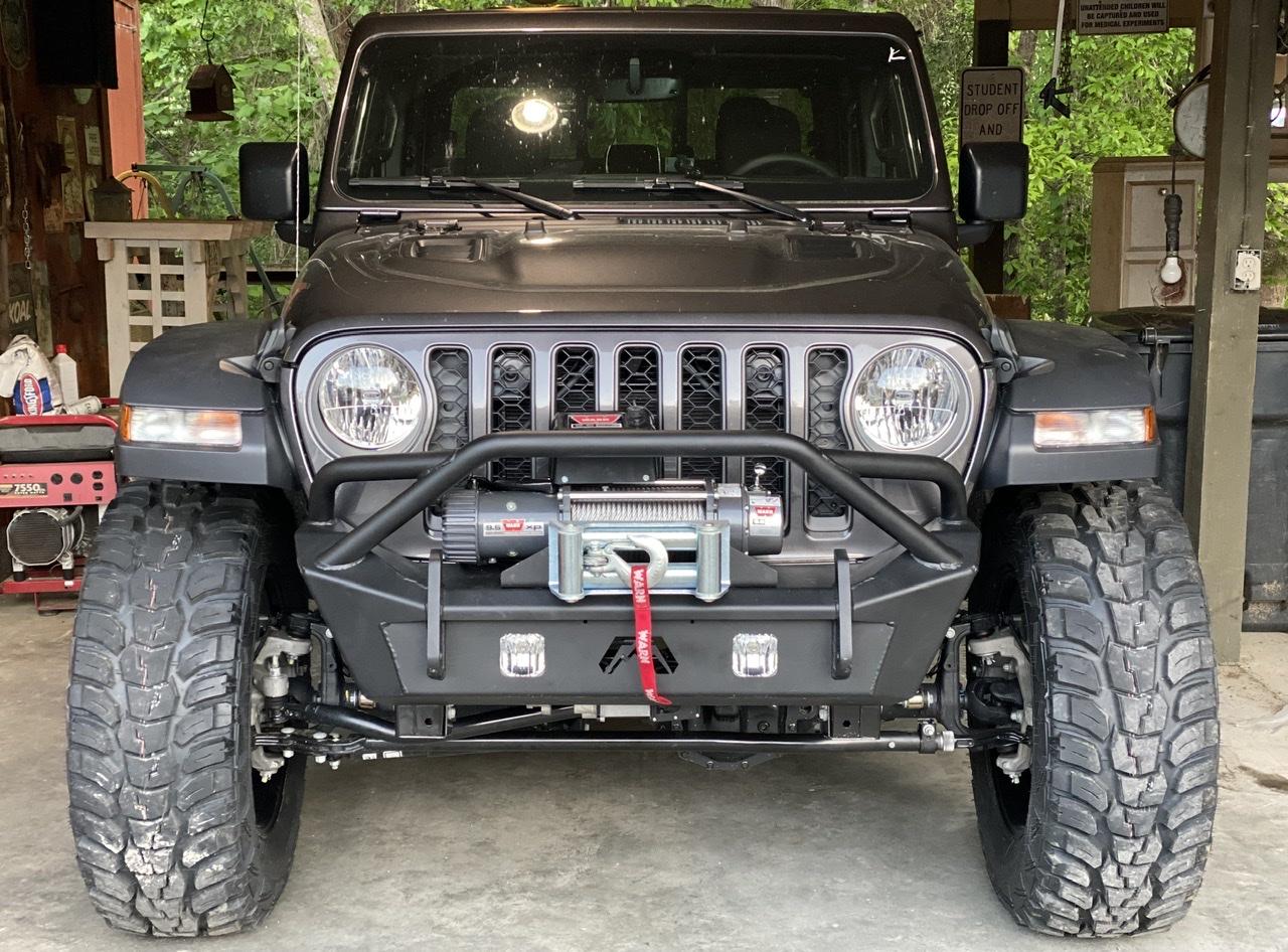

My setup... And yes, mine is mostly a DD/mall-crawler, but it does see off-road use regularly. It is still a 4x4 truck, so I use it as such (hunting, fishing, recreational shooting, exploring, etc...).

I also prefer the lower mount. This one on the factory bumper.
Mar 5, 2020
1,954
2,404
Lake Martin, Alabama
  1. What bumper is this?
Fab Fours Stubby with a (NOS - new old stock) Warn 9.5XP. I bought that winch new in 2006, and it stayed unopened in the box since then, until I installed it on my Jeep last Saturday (14 years). I bought 2 of them for an offroad project that never came to be, and I ended up selling the truck, and selling one of the winches, and kept that one.
I got mine from PartsHawk on eBay... They were cheaper a few weeks ago. I bought mine for $400 after taxes and PayPal fees. They have gone up since then, apparently due to popularity.
https://www.ebay.com/itm/Fab-Fours-JL18-B4752-1-Stubby-Bumper-Fits-18-20-Gladiator-Wrangler-JL/254470082329?ssPageName=STRK:MEBIDX:IT&_trksid=p2057872.m2749.l2649
Three things I can guarantee... 1.) You'll love the bumper, and it's strong as hell, and the fit & finish is excellent. 2.) Installing the factory fog lights is a pain in the ass, be prepared to cut the top plastic on the mount (doesn't affect anything) to get the mounting holes to line up, and removing the harness from the factory bumper requires complete disassembly to get it out. And 3.) you're UPS guy will hate you for ordering it...It's heavy duty! :CWL:
But, all that said, it's worth it! :like:
