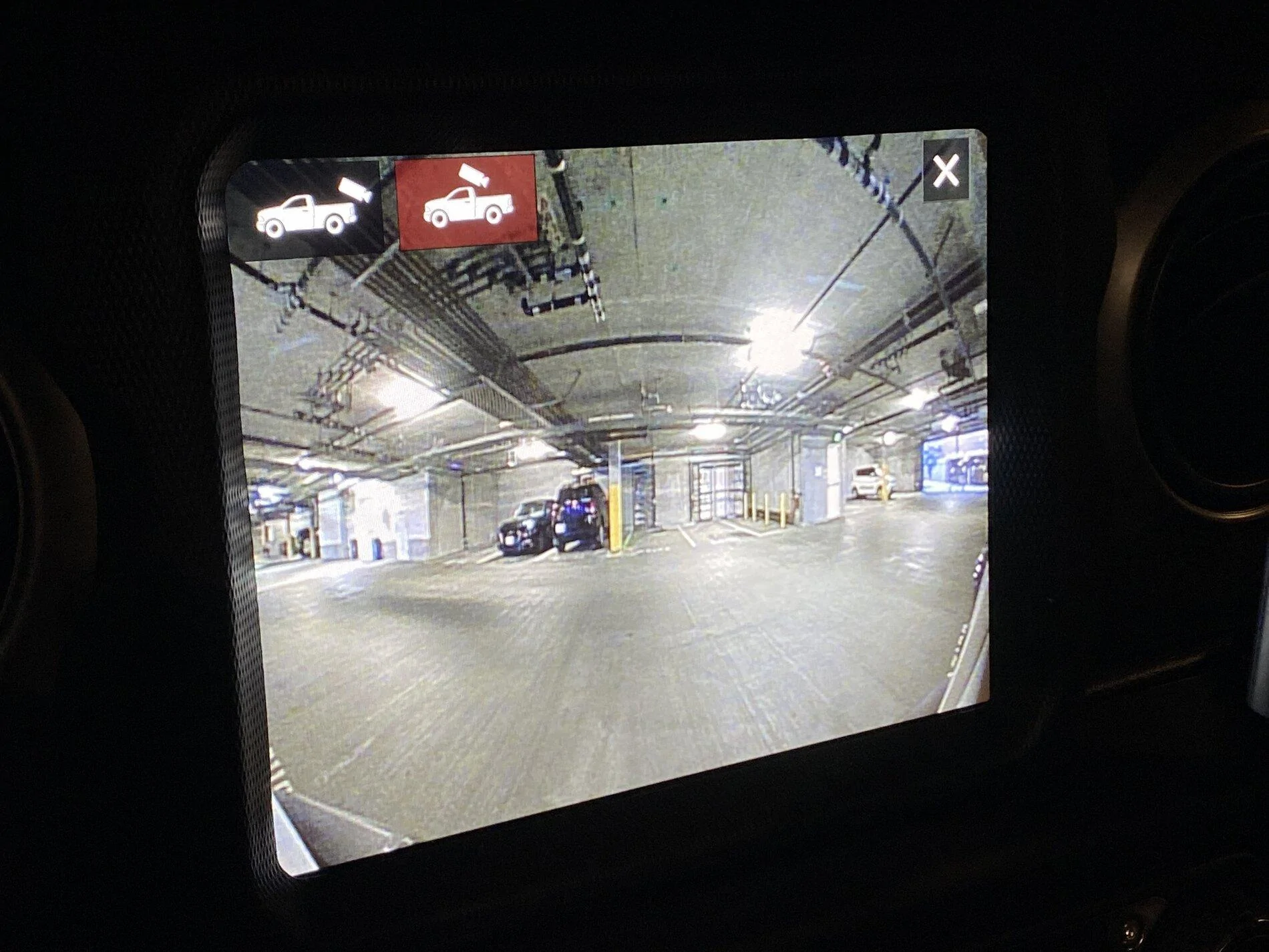

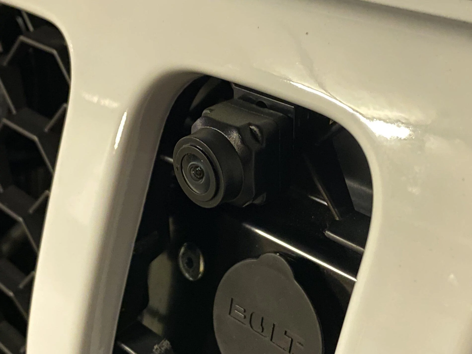

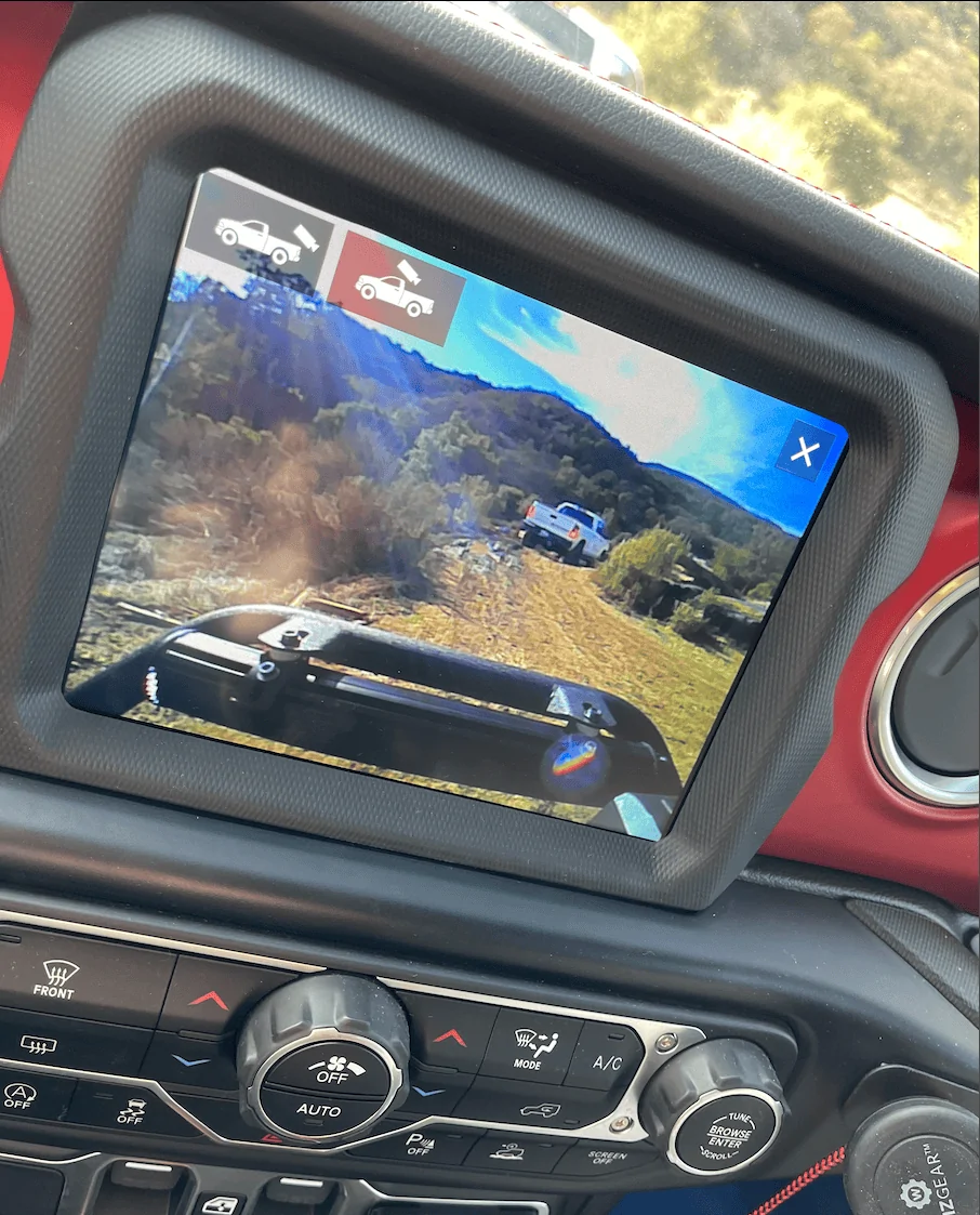

I'm running the Z automotive front facing cam. It's not HD like the rear cam but it gets the job done. Install was fairly simple, I'm satisfied with it. I have to add that Z Automotive customer service is outstanding.

Can you take some shots of it? I would like to see real world images.

I'm thinking of doing this- How long/ difficult was the install and what programmer did you use? The reviews on Amazon are mixed- so I was hoping to get more info.
Fairly easy if you watch a bunch of YouTube installs. I went the extra step of routing the signal and power wire through the firewall so my install was little more involved but it came out factory clean. I used a TAZER JL Mini to enable the camera.
