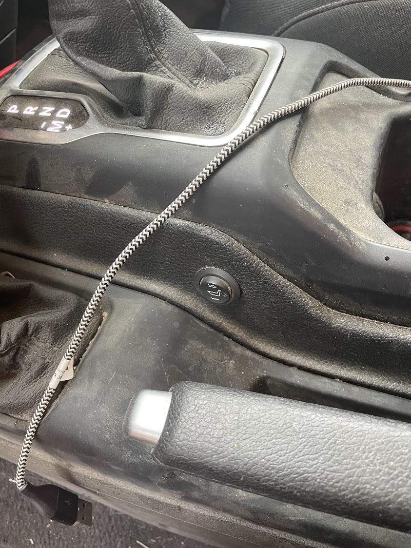

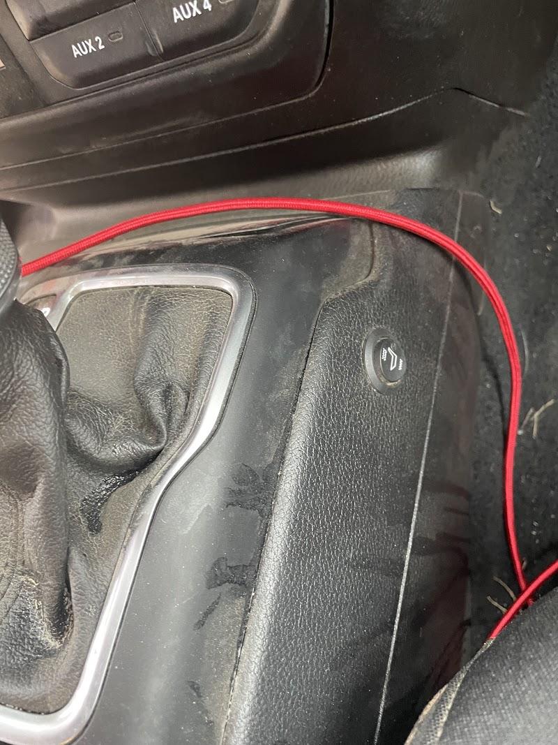

Yeah it doesn't look too bad. Here is where I put mine.
Ignore the dust
Jeep Gladiator Aftermarket Heated Seats and Auxiliary Switches IMG_1735 (1)
Which heated seat did you go with and did you run into any difficulty installing them under the seat covers?
