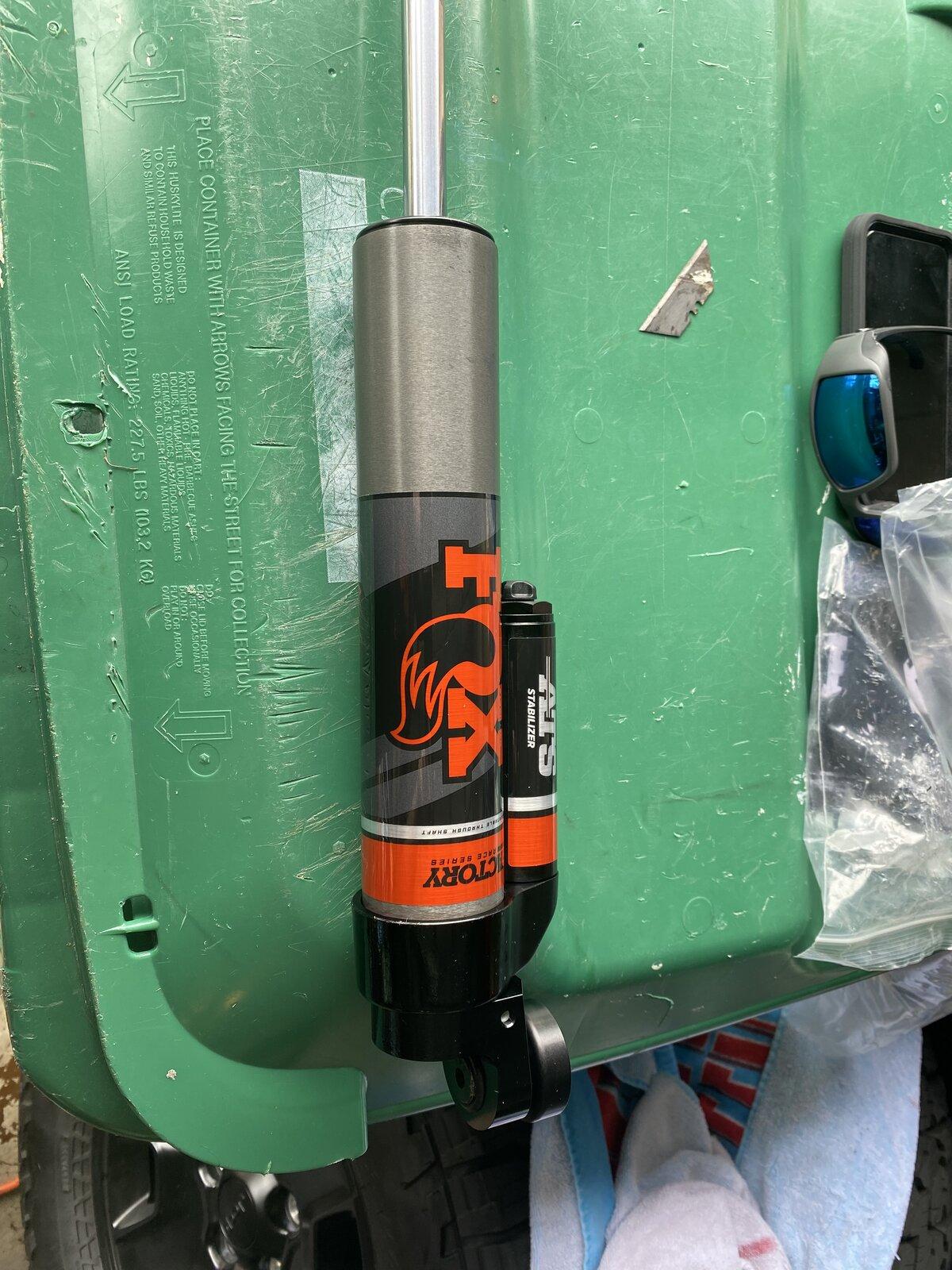

Anyone with a 2021 JL or JT have an issue installing a steering stabilizer? I reached out to FOX before I purchased an ATS and I received this in return
“No. Stabilizer applications for all 2021 Jeep JL / JT models are waiting approval due to changes in OE mounting hardware.
Thank you,
Sales Department
Offroad Division
Truck | SUV | Offroad Race | Defense
any thoughts?
any thoughts?
Jeep made a change in the bolt I believe. The 2021 factory has a different shape to it and won't fit into the aftermarket steering stabilizers. Jeep didn't bother to notify any vendors of this change.
Another thread has ppl installing a different bolt from 2020 JT/JLs. Hmmmmm

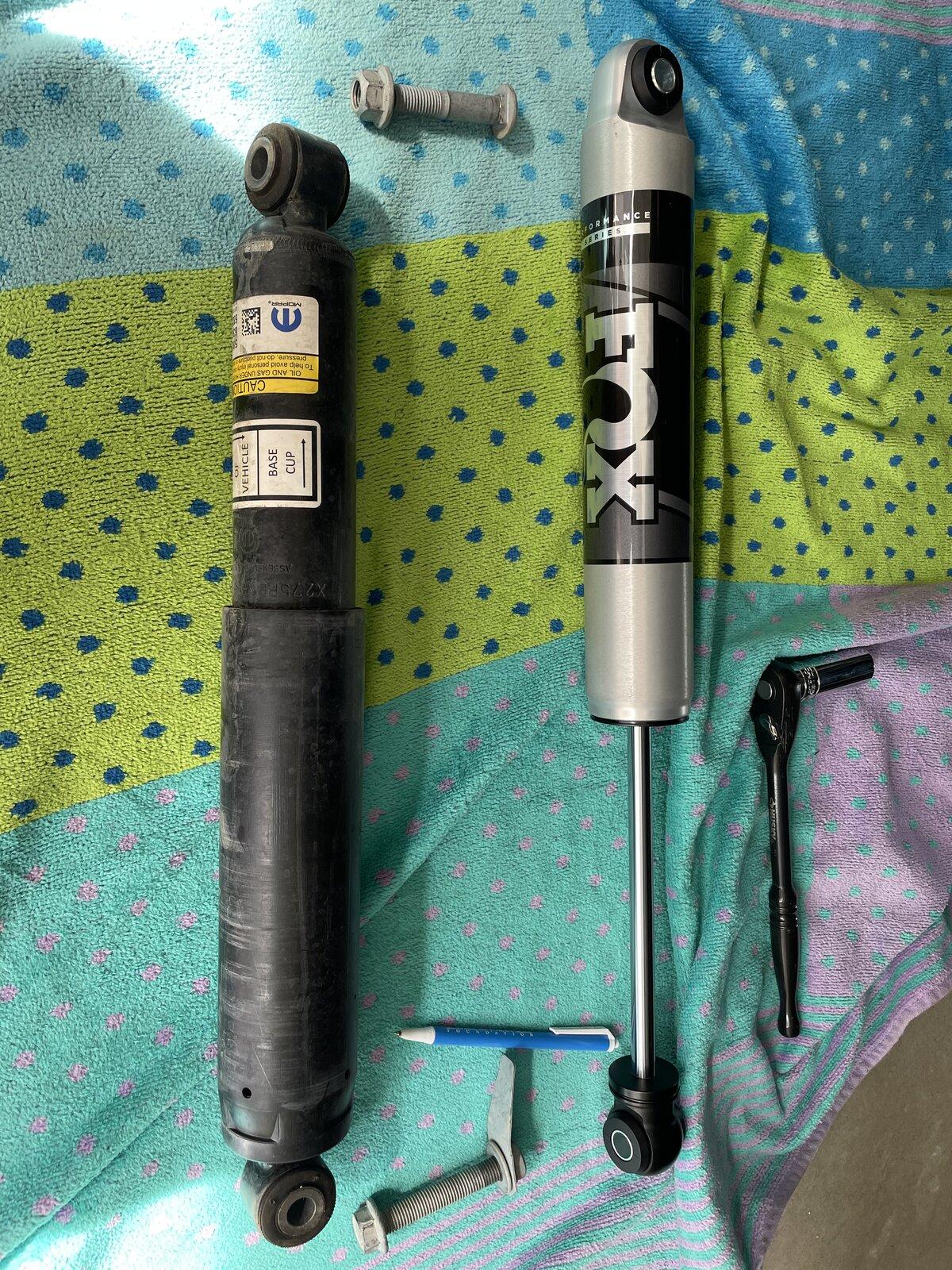

The new Stabilizer bolt has a longer square section at the top of the bolt. Presumably, to make installation quicker and easier. The factory Stabilizer has the bushing modified to accommodate the change. Anyone installing an aftermarket Stabilizer just needs to get an older style bolt.
Just finished installing the IFP stabilizer on my ‘21. In the interest of furthering knowledge - my 10/2020 build date 2021 JT has the old bolt style.

If anyone is looking, QUADRATECH has about 20 FOX ATS 983-02-148 in stock. I searched every where and everyone was on back order. QUADRATECH had it to me in 3 days
