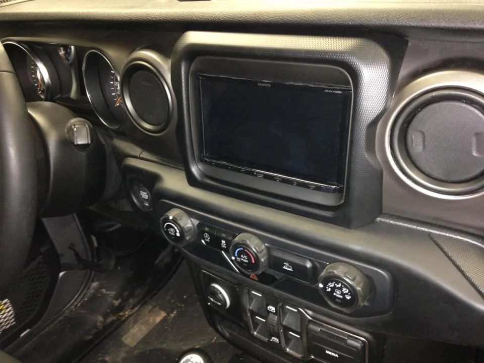

Starting the process of upgrading the entire audio system of my Sport S. This is the test fit of a modified dash kit and Kenwood DMX706S. Still a bit more work on the kit and then to order the rest of the gear for the upgrade.

Finally got my new Kenwood eXcelon DMX706s installed and working. We installed it with the Maestro RR and have it working with most all functions operational. We do have a couple things we have to work on. Here are the Pro's and Con's to replacing the factory radio that I have found so far. This is for the 5" Base Radio.
Pro's
I now have TPMS, Vehicle Data, and Guages on the radio.
I now have Climate feedback on my radio screen. No control just feedback
I now have Apple CarPlay / Android Auto
I now have the ability to add a front Offroad/Parking camera
I now have Navigation
Con's
The factory USB ports will no longer work, so I had to add a new USB port
Still working on making the factory backup camera work. We believe it will, but will require an adapter plug. It is on order and I will report back when we know for sure.

For Navigation it does work of my phone via Apple Maps, Google Maps, or other Navigation App's. Finding a unit that has built-in Navigation and a short chassis needed to fit in the dash of the JT/JL is going to be a very difficult task.
I don't really use iTunes, but being Apple Car Play it will play music from your iTunes Library as well as many other apps.
We are ordering what should be the correct adapter to get the factory camera plugged in. We have read that the JL uses a different style camera that is essentially HD and it won't work with an aftermarket radio, but from the look of the plug it should so we have a bit more testing and hopefully by the end of the week I will have an answer on that.
We pulled the 12v plug from the left side of the console out and replaced it with a flush mount USB. We really hoped that the factory USB plugs (at least one) would have been able to work, but Jeep uses a Hub for them and the new radio can't access the hub to get the data.
My price would be a bit under a typical price for this as I have a lot of connections in the industry since I have worked in this field for almost 20 years. Based on what the typical prices for this gear is and the labor needed to install I would guess a range of $700 - $900 depending on options and location as well as quality of work. There is not a dash kit currently available for the JT/JL so my installer was able to order a few different ones from some other vehicles and was able to modify one from I believe a newer Jeep Grand Cherokee.
