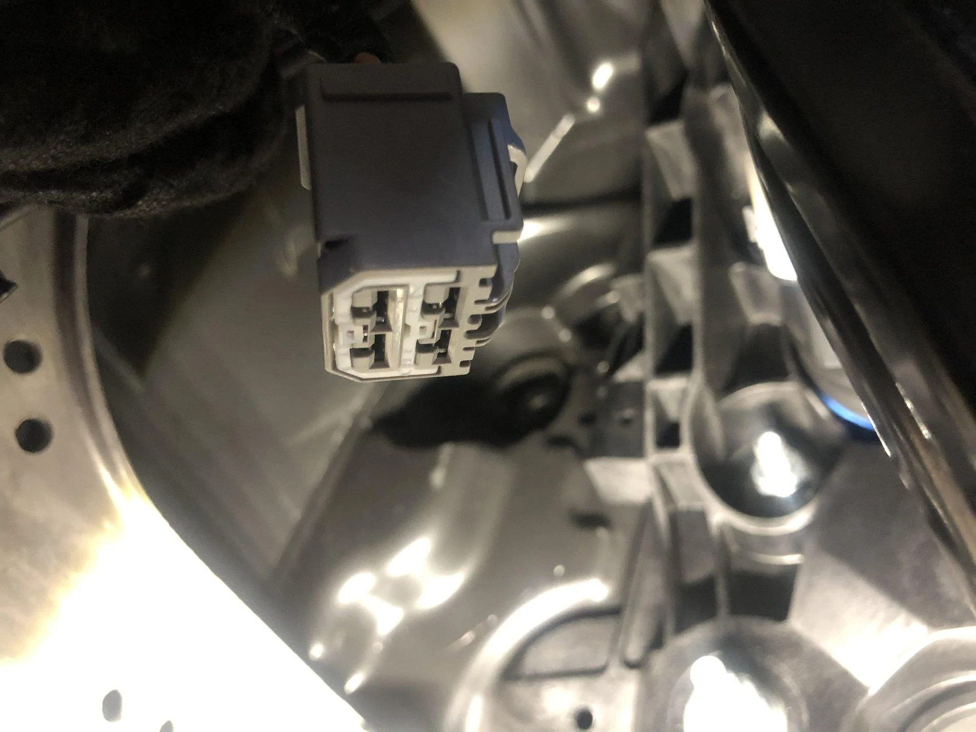

Is this the wiring harness your taking about?

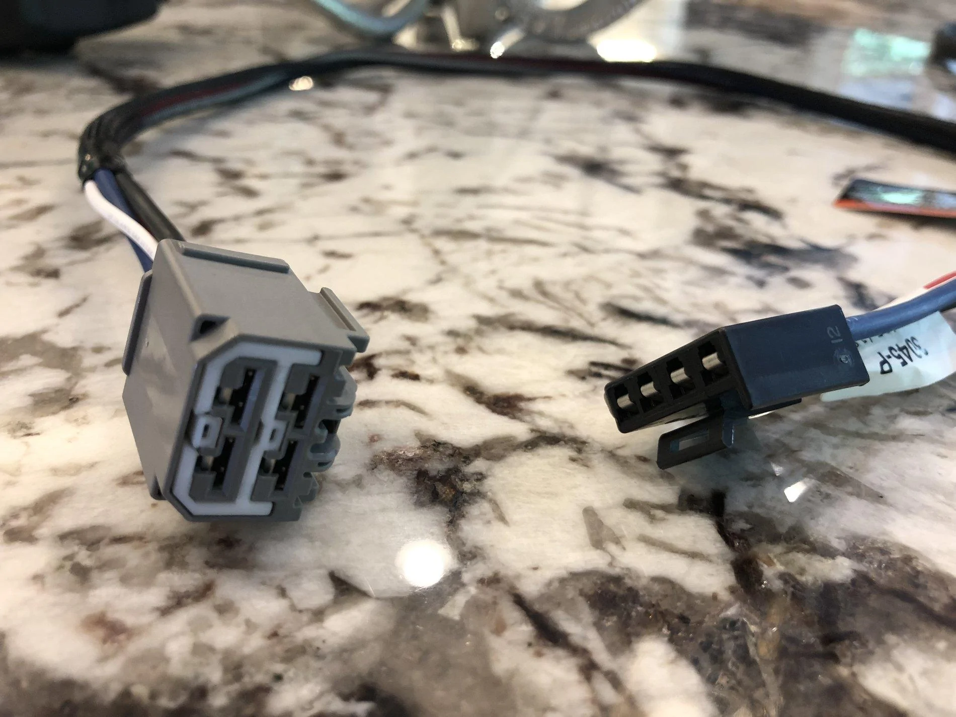

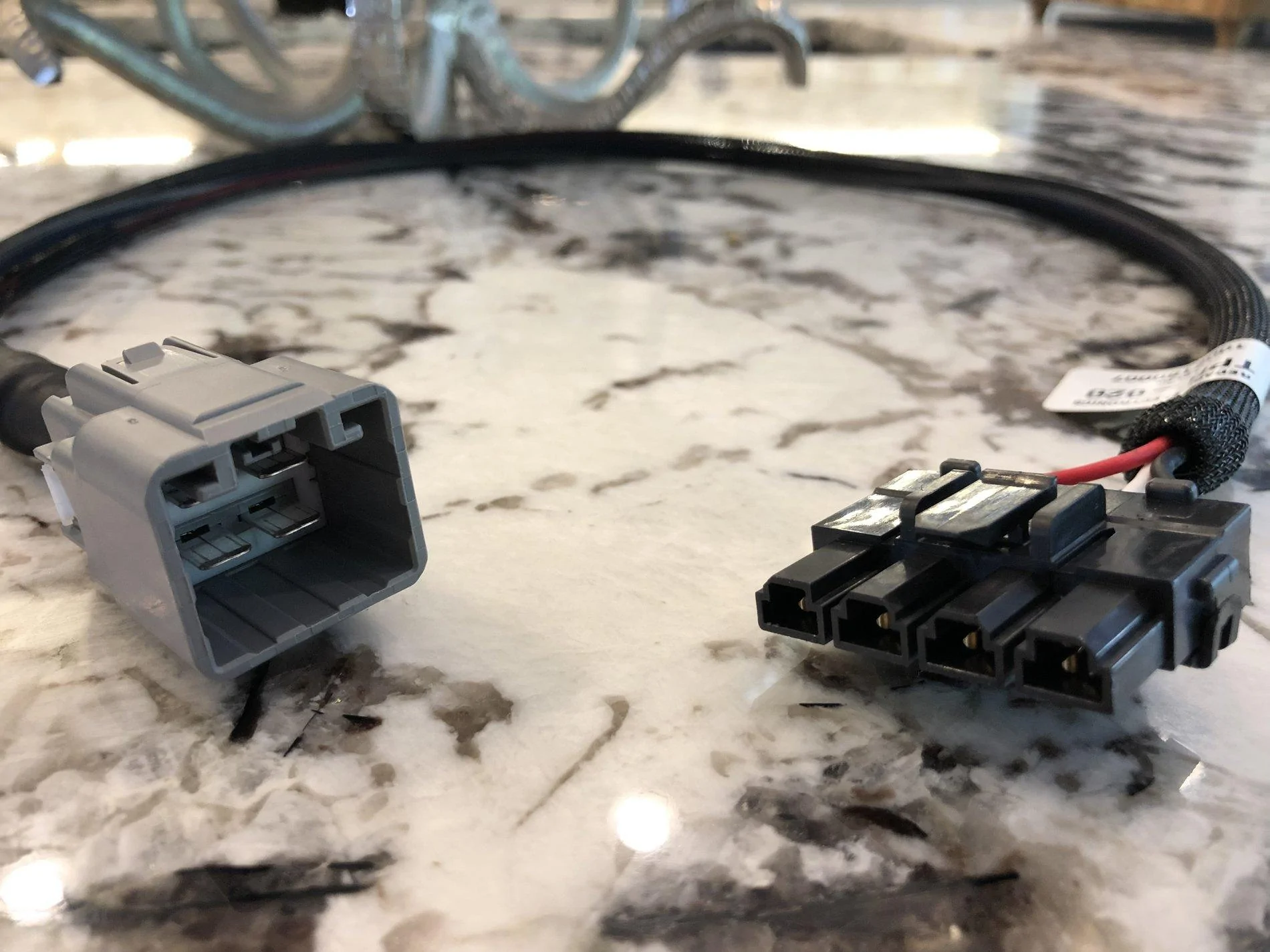

The following pics show the Redarc harness made for the 15-17 Ram vs the Tekonsha 3045p harness. Funny thing is is that they will plug into each other...
Tekonsha harness. The grey plug on the left is also the exact plug to look for under the dash and above where the clutch pedal is or would be. Black plug on right plugs directly into a Tekonsha controller.
Redarc Harness grey plug on left plugs into grey plug shown above that is found under the dash Black plug on right plugs directly into Redarc controller
Thats it. The plug in the gladiator is above the clutch pedal, or where it would be if you dont have one. Mine was pointing upwards and was kinda hard to find.
