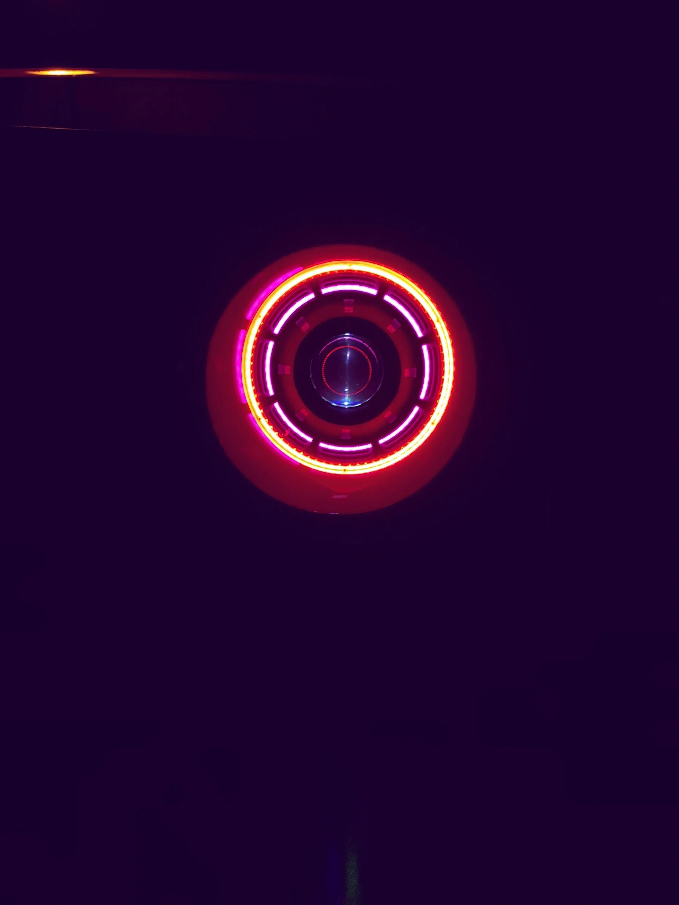

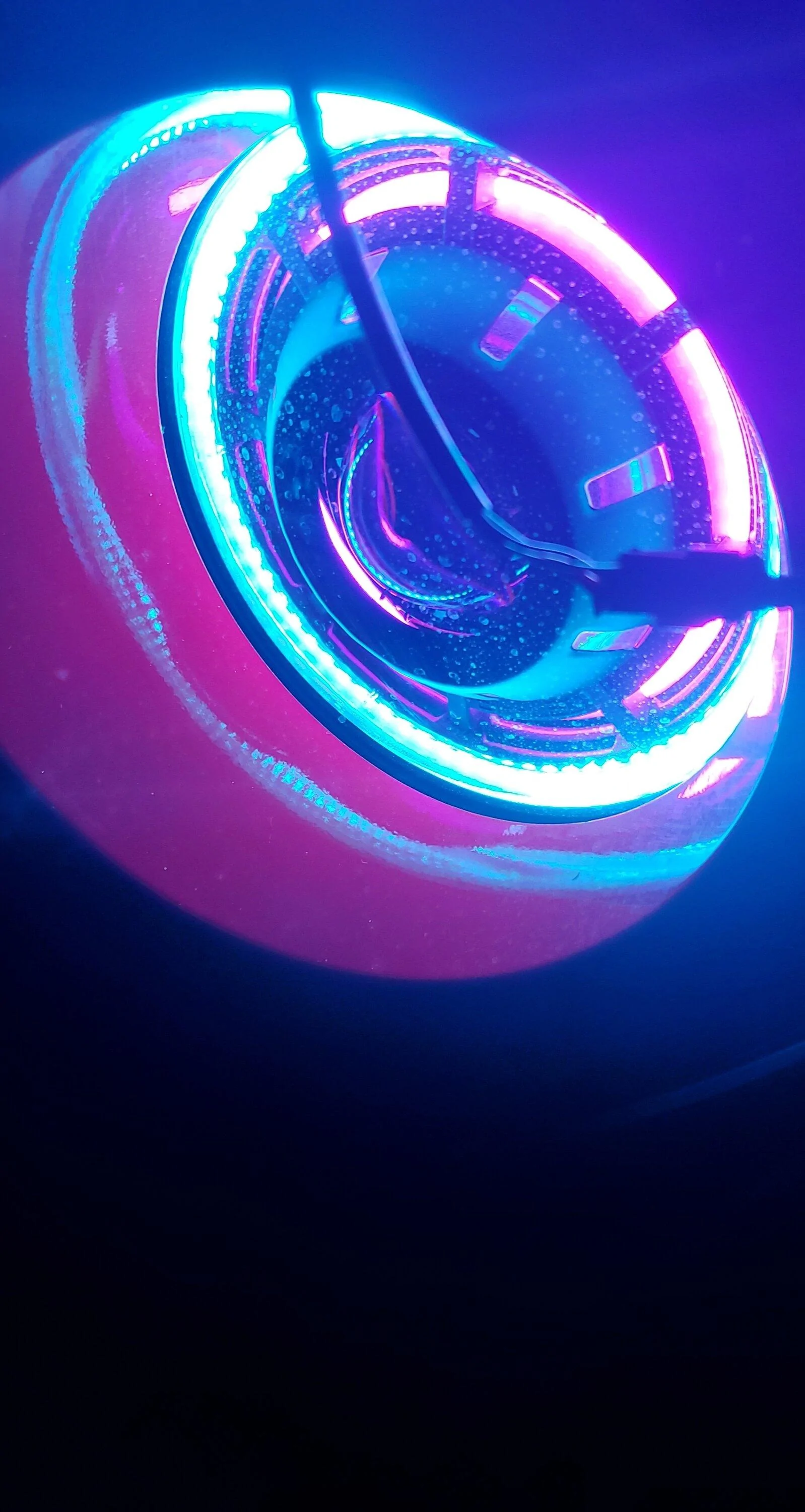

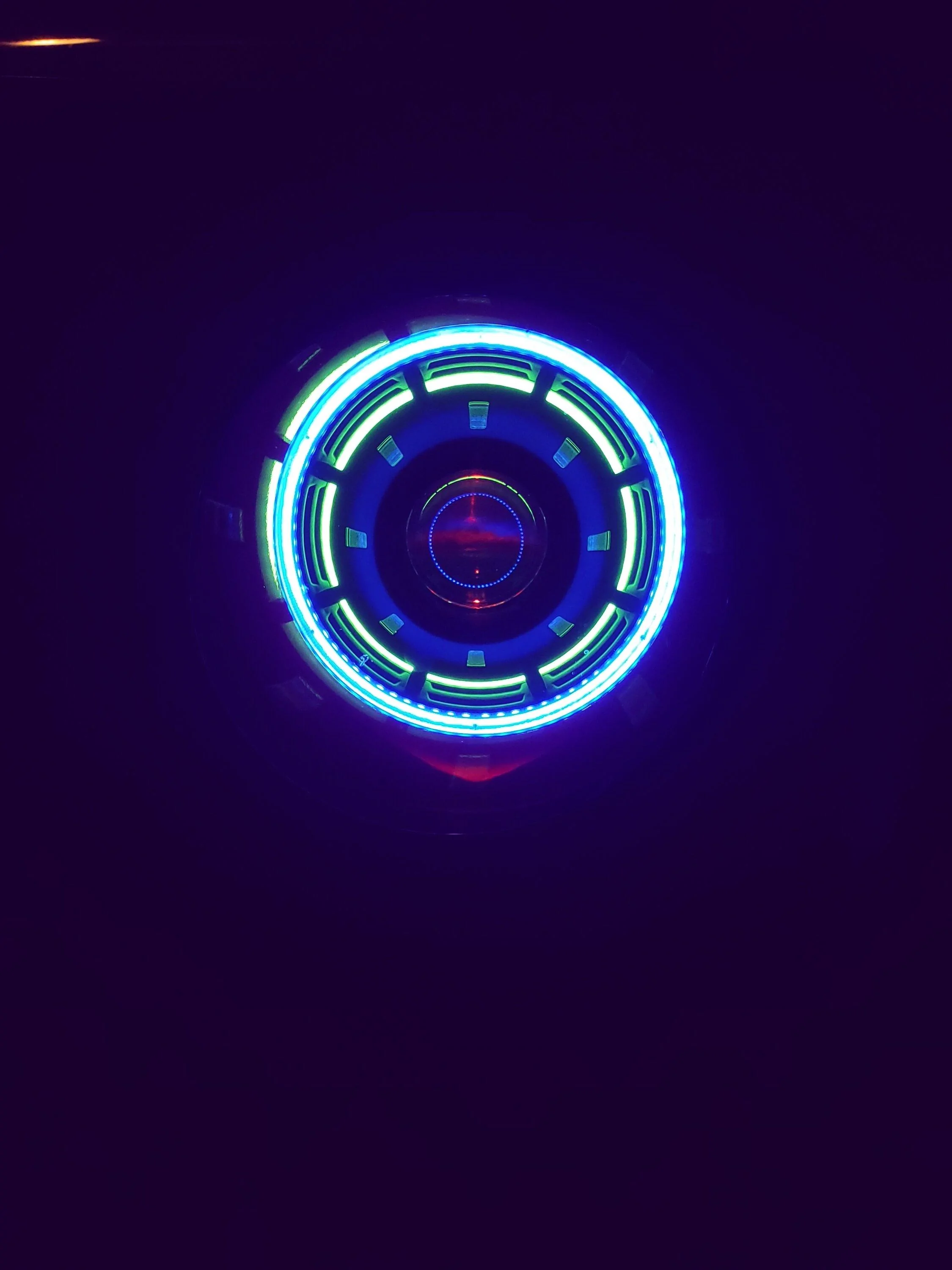

4.When the REGULAR headlights are on, are all three zones supposed to light up? I don't really see the inner or outer halo lighting...

The halos have the 3 different zones. They should only activate when the controller is on.
