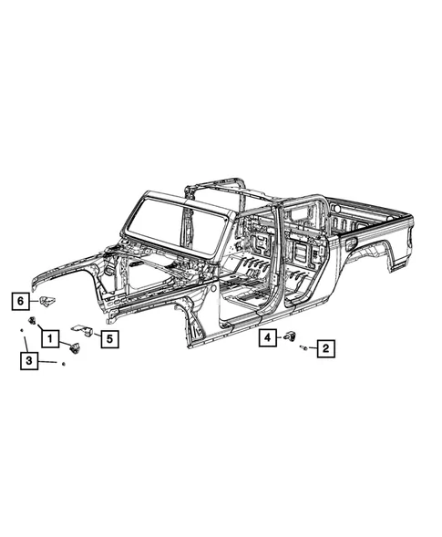

Just curious where the sensor(s) for the air bags are located and what the look like. I guess I always figured they would either be in or damn near the bumper but that’s clearly not the case at least with a Jeep. With rough off roading and all that goes with it, they must not be very sensitive or rather very sensitive to only a very specific type of shock that only occurs in a collision.

They are listed as "Acceleration Sensor".
Two in the front end, behind bumper exact location unknown.
Two located on B pillar, exact location unknown.

Is it a state secret or just you don’t know?

I don't know.
Not having to mess with them, I haven't gone looking.
I looked at a parts fiche for each and they only show general location.
Fair enough, thanks

#1 & #4 in picture
Jeep Gladiator Air Bag Sensor Location? 4a4ba4f5b1979e4cf14568698fcc4fc3
Lol, yeah I see what you mean. Not real detailed on appearance or location. I guess they figure if they need replaced the vehicle is almost always totaled so there’s no need to fool with them.

I think the JKs had the main sensor (combo accel/gyro) located near/under the center console.
