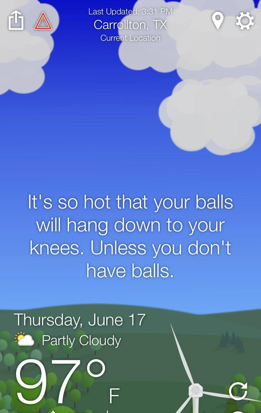

I think youā€™ve got a problem. My JT got nice and cold inside today.
This is my weather:

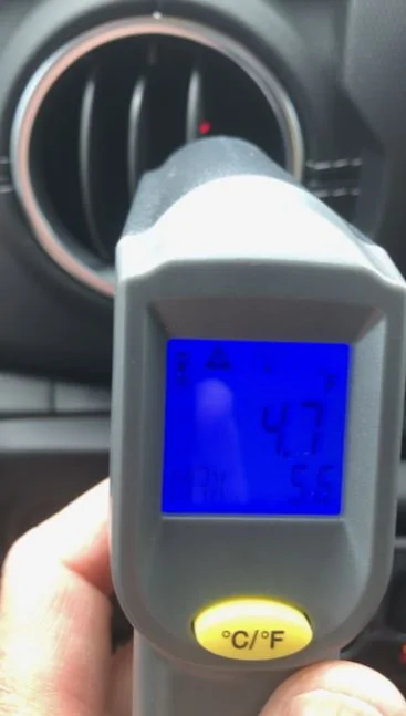

A couple of days ago (it was about 80 degrees out) I took the temp of mine while on low temp setting with the fan on high. I used an infrared thermometer. Of course, they say these can be off by +/- 3 degrees or so but it was blowing COLD.
4.7 degrees cold.
4.7 degrees cold.
Iā€™m suspicious of your measurement technique. Design temperature for automotive A/C is about 40 degrees F. At 4.7 degrees, youā€™ll soon ice up the evaporator, regardless of humidity content.
I thought this was quite basic. You can see in the photo what I was using and where it was aimed in the vent. It was after starting the vehicle with the fan on high and temp set to low. I did not say it maintained this temp over time, as I did not test it over minutes, just seconds. But, this clearly is what the infrared thermometer read.
If this is an incorrect technique to measure the temperature of the air coming out of a vent, then please the advise proper way to check the temperature.
Youā€™ll want to use a real thermometer, put it in the vent, let it run for at least 10 minutes. Thereā€™s no chance in hell that the air coming out your vent is 4.7F. Celsius would make sense, but no car AC on earth puts out below freezing air. 4.7 degree air directed at your face would injure people.
