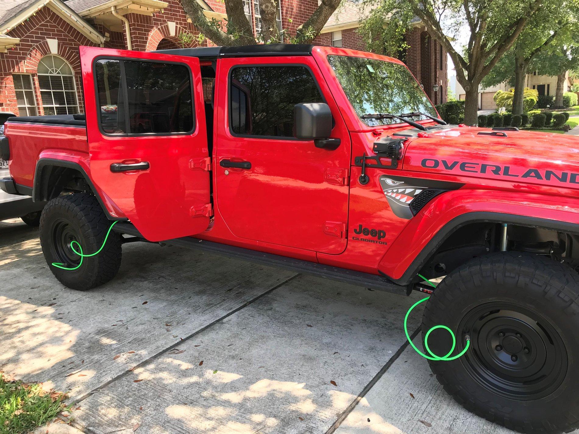

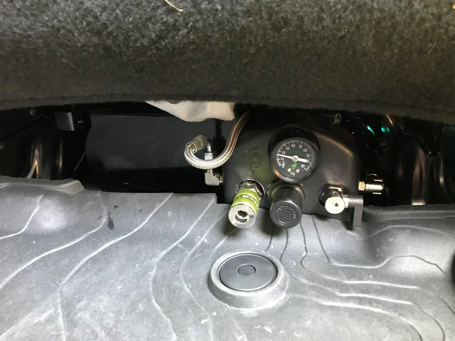

i have the twin ARB underseat mount hooked into the Air up down system a small whip for each wheel & regulate air up pressure all four at once & air down all at once.
Ronjmurray
Ron
Feb 22, 2021
Boerne, Texas
2020 Gladiator Mojave - Gobi
Software Engineer
Jeep Gladiator Air lines to the wheels green hoses
